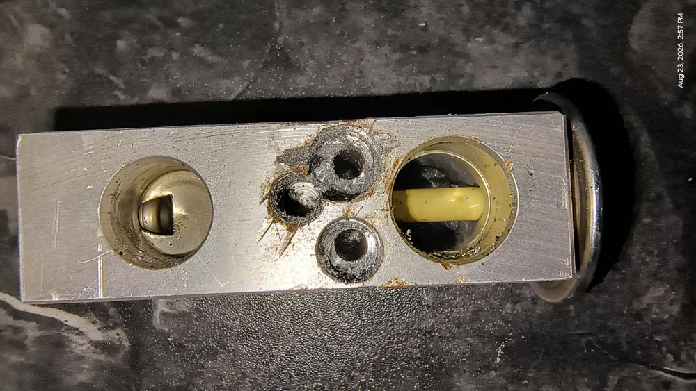

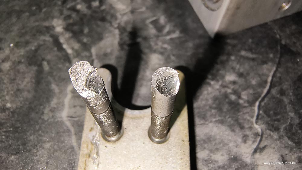

It took me quite a bit to get the heads drilled off clean enough to pull the valve out. It's very difficult to drill a concentric hole in that bolt, which is recessed and through the T-25 machined slot. Seems I went off center at some point and ended up drilling at an angle which left a small piece of the head clinging on the side of one bolt which added and extra day and 4 hours to the removal process.
I think if you could get the holes drilled dead center and straight down the center this would be a fairly quick job (with Cobalt drill bits)

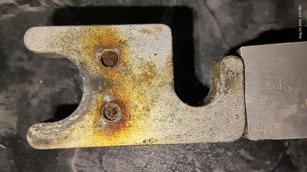

Here's a few pics of the removed parts.
The final, butchered expansion valve after all the drilling The back side of the Exp Valve mounting plate. Aluminum with steel bolts...dissimilar metals problem.
Rust! I knew it! I'm not sure exactly what yet....but I'm gonna paint the replacement bolts or use stainless or something to try and prevent this if ever I need to change this Exp Valve again. I'm gonna guess from this that this expansion valve is the original from 2001. I'm sure these are grade 8 or grade 10 bolts. It took Cobalt bits to drill them out. Another, maybe more risky procedure to remove these bolts came to mind after it was all removed. If you're extremely careful, once you turn the two bolts as far as they can go before they jam tight, you'll get a nearly 1/4 inch gap between the mounting block and the expansion valve. in theory, you could (being extremely careful) use a dremel tool with a cutting wheel to cut the bolts in that 1/4 inch gap. Obviously it depends on whether you have room to position the tool to get the cutting disk in there. Maybe there's a better tool that you can think of that might do that? Well, this still doesn't guarantee that I won't have to remove the entire dash to replace the evap core. In fact in this case, since it's a 2001 and it appears virgin, I'm thinking it might be dumb NOT to go ahead and replace the evap core. If it's also original I have to assume it's either leaking or not far from it. In Gen 3 and Gen 4 Dodge Caravans (from my experience since I own 5 of them), 10-11 years seems to be the evap core lifespan depending on where it was parked most of the time. Under trees make it 6-7 years.
