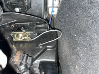

Changed the temperature sensor to one with a different range, 34-43F (rather than the kit supplied 24F low range) and now the compressor cycles and maintains a pretty constant air duct temperature. Luckily with this after market system I could make that modification and replace the sensor.
You can definitely hear the compressor when it comes on with a “whoosh” and cuts out quietly. Not sure if that’s a problem but I will live with it since it is maintaining an air duct temp in the green zone (36-44F) on my air temp thermometer.
