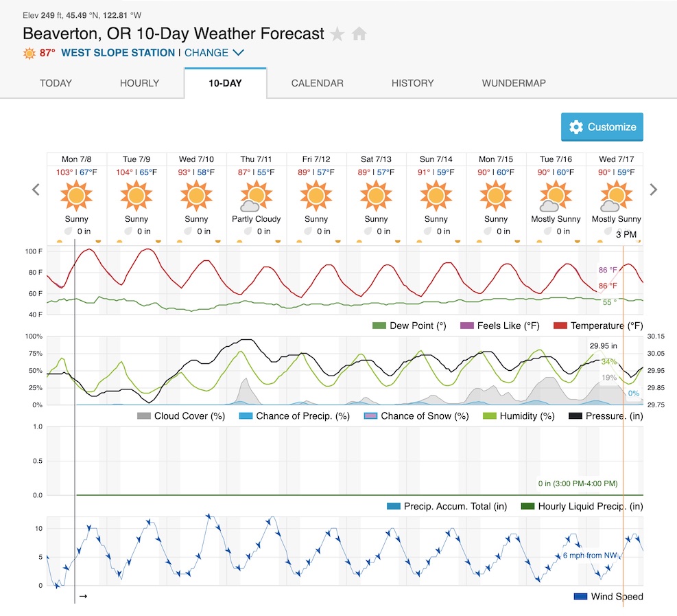

Is there a lot of humidity in your area? That will make your AC struggle. The air temp cannot be reduced until the humidity is reduced. Humidity is termed ‘latent heat’. You mentioned you thought it was low, wonder what the weather channel says. I always thought it was humid there

It is not humid in Oregon in the summer. High pressure sits over the east side of the Cascades, and when the ocean breezes flag, we get hot dry east winds. When the humidity on a summer day hits 60% with a high of 75, the natives moan "What's up? This ain't Michigan, is it?"tbirdtbird wrote: Mon Jul 08, 2024 9:19 am Agree. You always want to fit the largest condenser .
