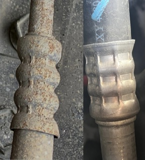

Thanks for the pix. Those crimps are not proper for AC work.. AC automotive requires so called bubble crimps. Nothing else will do….period.
Find another shop and ask to see their crimping dies.
We are not allowed links to other sites but if you google automotive AC hoses and study the crimps you will see the difference.
Be certain the hose is rated for AC use…at least 35 bar and -40 C to 135 C

That’s a picture of a new oem hose. It won’t let me post a picture of the actual crimp that was done on the hose, but it looks like the same crimp used on the rest of the oem hoses on the vehicle. I’ll have to check on the hose pressure ratings.

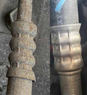

On the left is an oem crimp from the semi truck.
On the right is a crimp from a car.

The OEM should hold. As mentioned, bubble-style crimps for barrier hoses are the best method.
