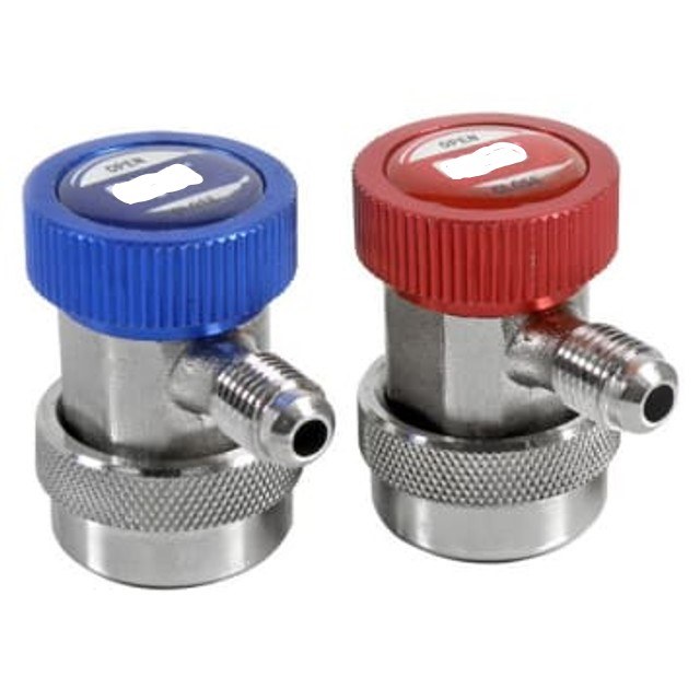

Re: coupler for nitrogen regulator to manifold guage set
If you have a set of Service Port Adapters for R-134a with 1/4" flare fittings where the hoses attach (pictured), an R-12 hose with 1/4" knurled flare (female) fittings on each end will screw right on.
- ServicePortAdapters.jpg (48.53 KiB) Viewed 39250 times
