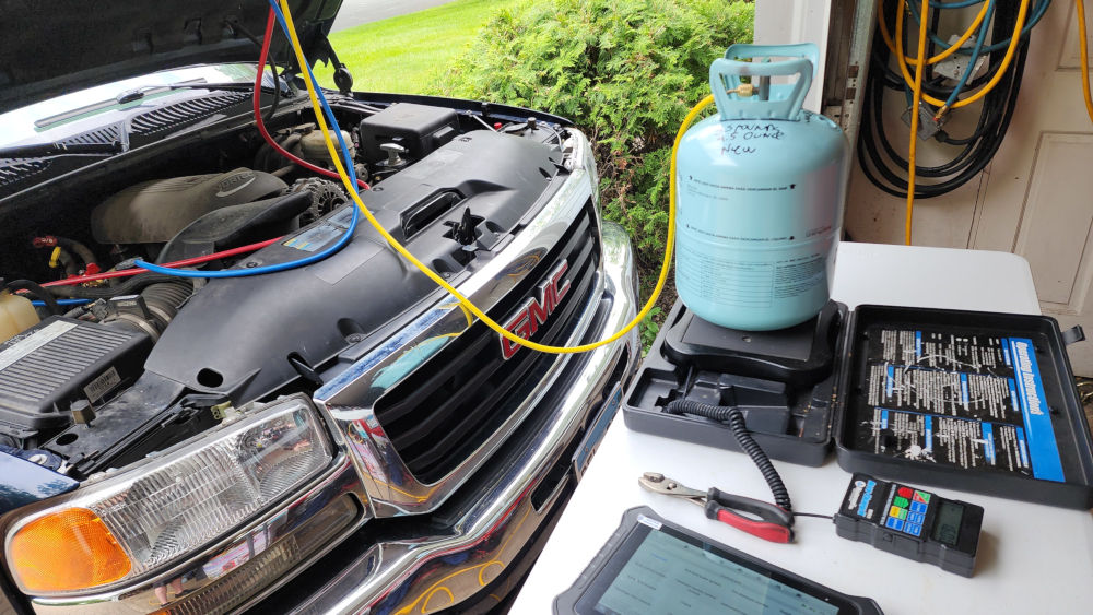

This problem is with my own truck.... It's a 2006 GMC Sierra 1500 with the 5.3 engine.
I had a leaky evaporator but if I charged the system with refrigerant, it would cool really well. It was a working system that needed a new evaporator.
I decided to replace the evap along with a new Denso compressor, a new accumulator, and a new orifice tube. All the repairs went well. I vacuumed the system for an hour and 15 minutes and achieved a vacuum level of just over 1000 microns. I charged exactly 1.6 pounds of new refrigerant from a brand new 30 pound tank of Chemours Dupont "Freon" r134a. This is an exact charge according to my digital refrigerant scale. I put 2.1 ounces of oil in the new compressor, 1.5 in the new accumulator, and 1.5 in the new evaporator.
Ambient outdoor temp is 77 degrees and my pressures seem normal to me..... at 900 engine rpm, they are right around 35 low / 175-200 high. (depending if electric fans are on or not)

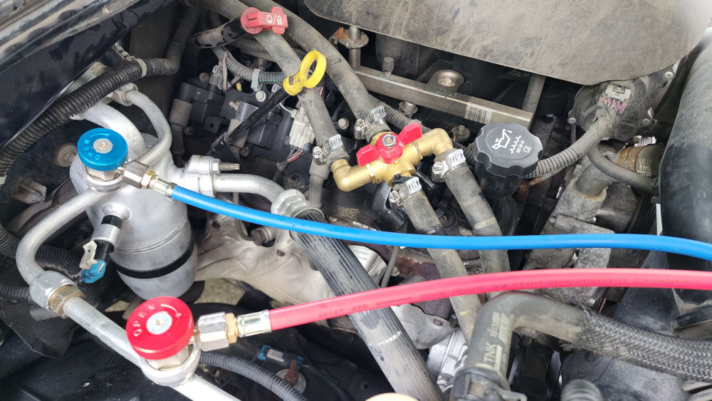

I have a heater core "bypass valve" installed that will isolate the heater core so it gets no hot water from the engine. This SHOULD prevent any cool air loss from having to overcome leaky blend doors in the HVAC box.
I even installed a temp probe in my HVAC box to see the temp of the evaporator. The prob goes into the box roughly 5 inches and the tip of the probe should be right in front of the evaporator on the discharge side. (where the cold air should be)
Why would my vent temps be between 50-60 degrees?
Shouldn't my evaporator be colder than 46-50 degrees?
60 degree vent temps are not acceptable on a 77 degree day, in the shade. lolol.
Any ideas why it's blowing warm?

A few more pictures....
- 20240530_145527.jpg (176.57 KiB) Viewed 16033 times
- 20240530_145453.jpg (147.13 KiB) Viewed 16033 times
