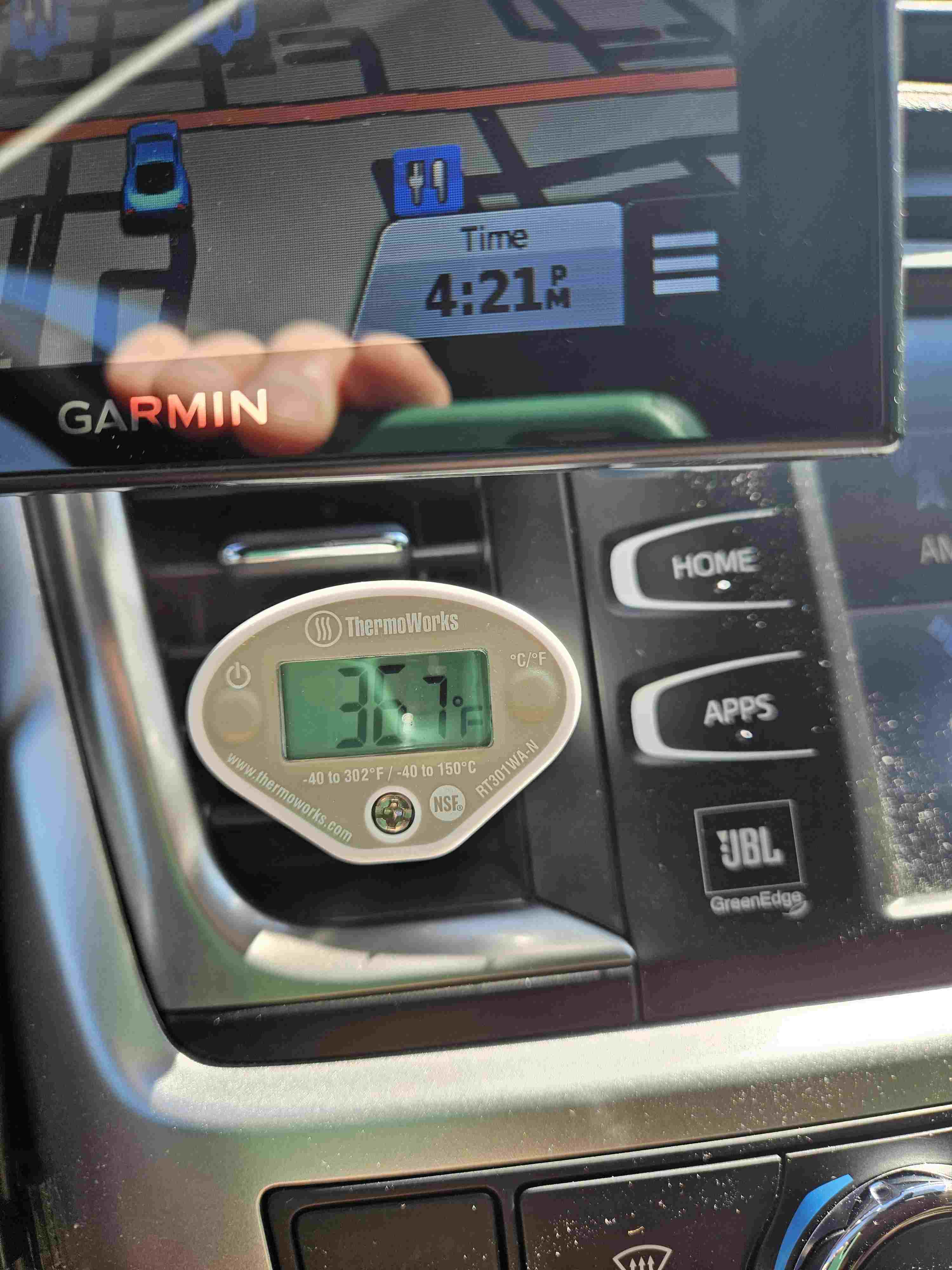

If you like to tinker with your MVAC and keep it in tip-top shape, like I do, consider investing in a pro-grade Manifold Gauge Set, a heavy-duty rotary-vane vacuum pump, an accurate refrigerant scale, a digital thermometer to monitor center-vent temperatures (if you don't already have one), and a 30-pound cylinder of R-134a. Then you can do it yourself. Consult Tim at ACKits.com for the pro-grade equipment.
If you need to recover the refrigerant before opening the system and doing repairs, a local shop can handle that for you at a nominal fee.
The photo (sorry...the quality isn't the best) shows a digital thermometer that I place in each of my vehicles to keep tabs on the A/C systems.
