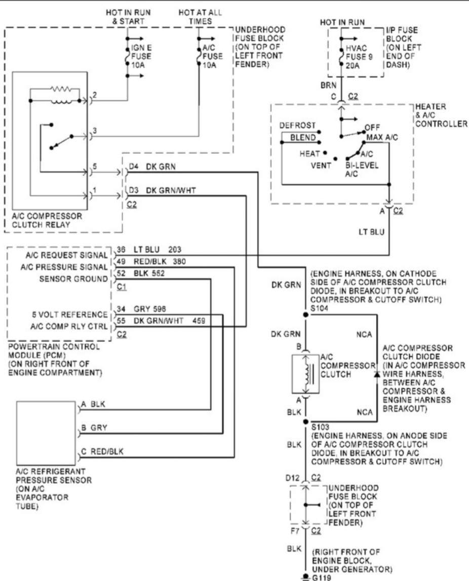

I have a 1999 GMC Sonoma 2.2. I've attached the wiring diagram for your reference.
Before I delve into it let me first state that my compressor clutch kicks in when jumping terminal and when jumping the relay terminal. I've also switched relays with the horn relay (it's good) and nothing
My pressure is good and the pressure sensor (3wire) is sending 1.9 volts iirc from the 5v reference to the ecu (I think that's how it works). There is no low pressure switch is just the one sensor on the high side line.
When I switch the ac on on the controls inside I hear and see the idle up go and then settle back.
I have back probed the PCM at the proper terminals and it all seems to check out.
On the relay terminal the 12v all time and 12v when key on its good as well as the fuses.
Also the switch terminal on relay is getting 12v. But it only shows 12v when I plug the relay in. But it does not send the 12v to the terminal for the electromagnetic clutch. I am at a loss of what the issue could be. It all seems to be pointing to the relay but the relay tests good. I'm just a DIY'er so I am not too experienced with this stuff. The truck blows ice cold air when I hot wire or jump it. Please help.

The compressor was replaced a few years ago but I had the ac running great last summer and I replaced the pcm because of a bad fuel injector ground control and now the ac is not working. but I dont know if it's because of the new pcm or what? I back probed the wires on the diagram on the pcm and the pressure sensor and was getting the proper readings (I think). I-m at a loss and don't know what to do. Any help is appreciated

It could also be the wiring from the relay to the clutch, the diode that prevents stray voltage induced from the clutch coil from traveling back to sensitive electronics, or the PCM itself.
Try the easy test first. Put a VOM's test leads across the wire between the relay and the clutch. If you get no continuity, then the wire is open someplace.
Let's hold off on the rest for now.

When I jump the relay the compressor kicks on so the wiring should be fine between the relay and clutch. But I checked anyway for continuity on the wire between the relay terminal that feeds the compressor clutch and it read 1.4 ohms.JohnHere wrote: Wed May 01, 2024 9:37 pm Okay...we've got the system charged to specs.

Then something has to be amiss in the area of the relay...maybe the relay itself or a loose female plug?Notnilc20 wrote: Thu May 02, 2024 1:44 pm When I jump the relay the compressor kicks on so the wiring should be fine between the relay and clutch. But I checked anyway for continuity on the wire between the relay terminal that feeds the compressor clutch and it read 1.4 ohms.
