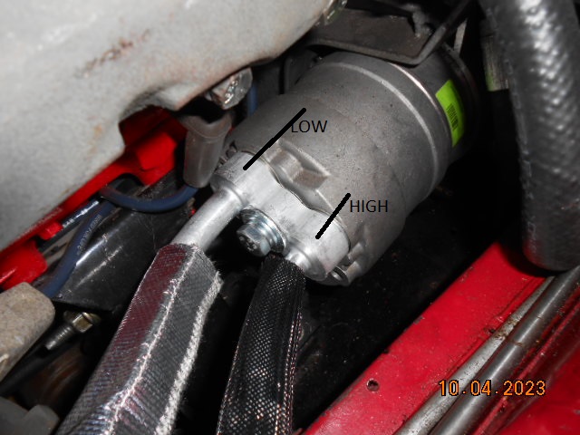

The GM compressor (4 Seasons) has no markings on it

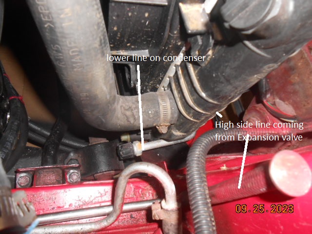

I attached the AC hose manifold but I am not sure whether it was done correctly.
Does the attached photo show the the lines connected properly? Is the low side of the compressor the one indicated in the photo?

Yes, your pic is correct. Be sure to insulate the comp from the very nearby exhaust system. Whoever designed that system put the pump waaaay too close to the exhaust. Your performance will be compromised

Do not bend the pipe on the compressor any further. It can easily be damaged. Insulate that area!!! Aerogel is one way to insulate

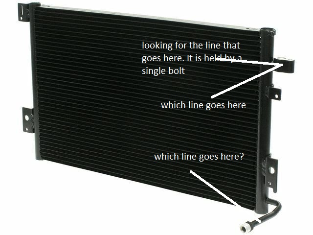

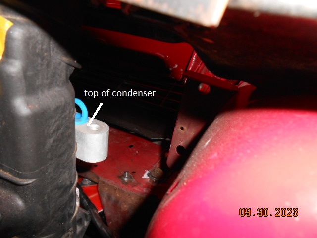

This is what my condenser looks like. What is the name/part number for the line on the top?
The lower line is about 1/2" ID.
I do not know what the size of the top line will be as I cannot find one.

Please review the hose sizes posted by Bohica at 9:41 this AM (above)
Be certain the condenser is upside right. You can tell by comparing the line sizes.
The larger diameter line always goes to the top (#8 hose), the smaller always to the bottom (#6 hose)
