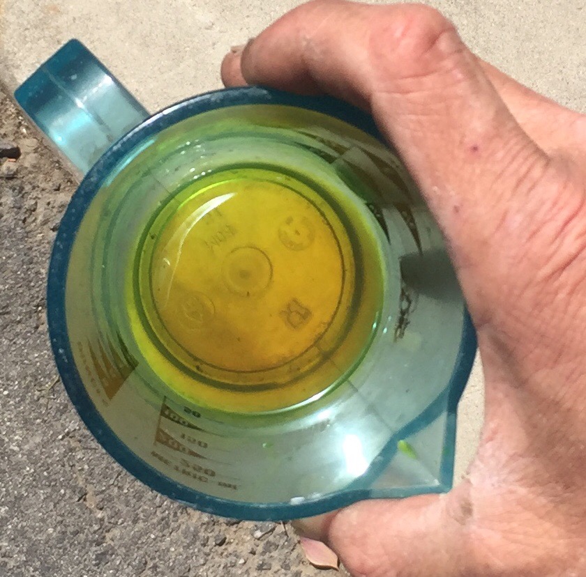

by BakoNavi23
Here is the oil I just removed from compressor.
Looks new to me.
It is super windy here today and sunny making it difficult to take picture and any little bits you might see were not from the system but my yard.
Re: 2006 Lincoln Navigator Replace Stock Scroll compressor w/piston type?
Posted: Wed May 17, 2023 10:46 am
To get you started,
"Can I clean the individual tubes (out of car) with water and degreaser or is a solvent flush the only way to clean?"
Under NO circumstances should you use anything water based inside an AC system. You will destroy the system.
Tim has suitable flush
