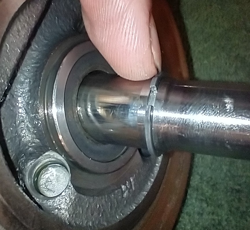

This is my first post, and I'm hoping an experienced person(s) can point me in the right direction.
I'm currently refurbishing a AC compressor. Mine was not working.. opened it up and it was in ok shape. No metal, but way too much oil. This was a 20 year old used car, and since I bought it it hasn't had AC.

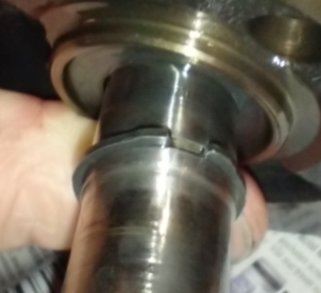

I'm trying to replace the plate that the half ball bearing things ride on. It's got some issues. I bought another slightly different model ac compressor. I pulled it apart, and the top plate that has the roller bearing rides on is different. But the bottom plate is the same. They are both held on by these clips:
Anyone have any idea how to get these off? There are no holes to get a removal tool on one. I am hoping there is a better procedure than jamming two screwdrivers in there. I've tried to grab em with needle nose, no go. Any insights would be greatly appreciated, thanks.
Posts: 1834
Re: Hoping someone has an idea for this clip removal
A special tool (reverse pliers) removes that type of snap ring. It's similar to the tool that removes snap rings having holes in the ends. But instead of pins, it has what I call duck-bill ends that bear against the ends of the snap ring. Your local auto parts store should carry them in various sizes.
On a 20-year-old car, why not just replace the compressor with a new one? It's probably getting "tired" anyway.
Post by SMB »
Thank you, I'll pick up a pair of those. I have a compulsion to tinker and take things apart. Last week I pulled the transmission valve body out and refurbished it. At this point it is not about having a functioning AC system, it's about having a project, learning something new, and add a tool to my tool box Thanks again, I joined this forum, like so many others, to learn and problem solve. Cheers
