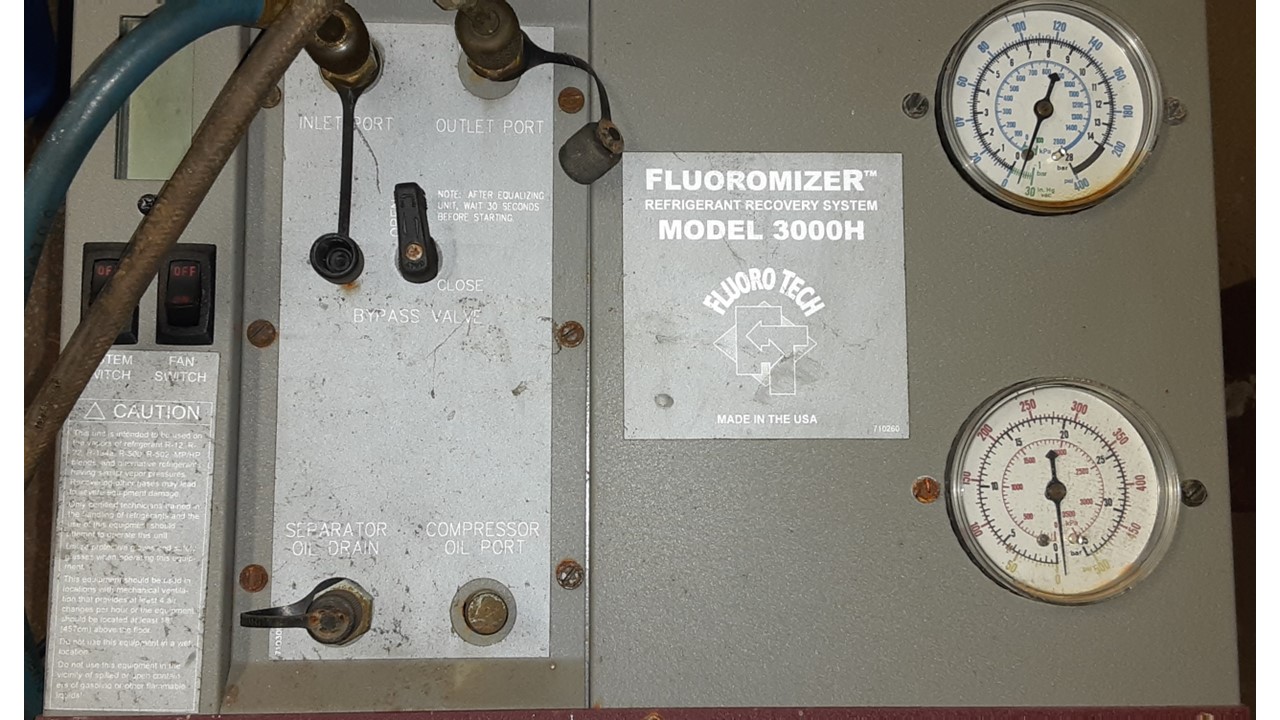

Plan B: I have access to an old Flouromizer 3000h recovery unit - was my late father's. I am guessing the unit is mid to late '90s vintage. I can not find a manual for this specific unit. I found a couple of manuals for newer units - one here: http://s3.supplyhouse.com/manuals/13039 ... D_FILE.pdf. Image of the actual unit:
I am trying to decide if it is worth the space to pack it into our Fusion for the trip back to the Detroit area from Houston this weekend - space is at a premium.
This recovery machine was underwater during the Hurricane Harvey flooding back in '18. The high vacuum limit switch has failed. I jumpered the switch and using some very old hoses, I connected the recovery unit to a gage set and the recovery tank and drew a vacuum. The time to draw the vacuum to 14 in Hg was very long (guessing 1.5+ hrs). I was thinking the old hoses were porous but the vacuum held steady for 18 hrs at which time I released it. The unit has a compressor oil port - does one replace the oil similar to a vacuum pump?
compressor oil port.jpg (248.27 KiB) Viewed 11448 times
Might it draw a vacuum faster if the oil were replaced? With out a manual, all I could do is replace the existing oil with the same qty. Next question - The recovery machine has an oil separator port - might I be able to measure the oil pulled out of the system during recovery? If so, does one open the port after the recovery process is complete or while it is in process? The curved red line shows where the tubing exists the box.
Why does the recovery cylinder have 2 fill ports/valves (unable to attach a 4th image)?

14 in Hg is no where near sufficient to properly charge a system, you need to shoot for 500 microns. I think I would leave it behind.

You could contact Bacharach to see whether they can help with a manual. But with the flooding and the other questions you have about the old recovery unit—and wondering whether it will work at all—would compel me to leave it behind. I wonder, too, whether there's any R-12 in the system to begin with.

Cusser:
Thanks for responding. I was thinking I should be able to recover most of the refrigerant with the method you described. I actually found the manual (dated '97) to my father's old recovery machine the day before we left the Houston area and it answered all my questions posted in the original message and I found in the manual that the high vacuum switch (sometimes) needs 1 to 2 PSI to reset so it might not have failed after all. So I squeezed the recovery unit and recovery cylinder into the truck of the car before heading north. So now I should have 2 recovery options next spring.
