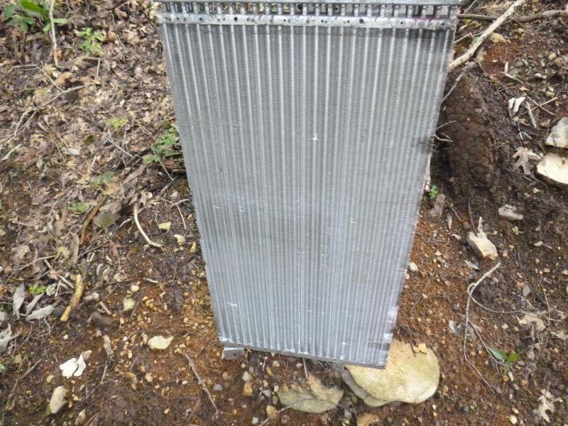

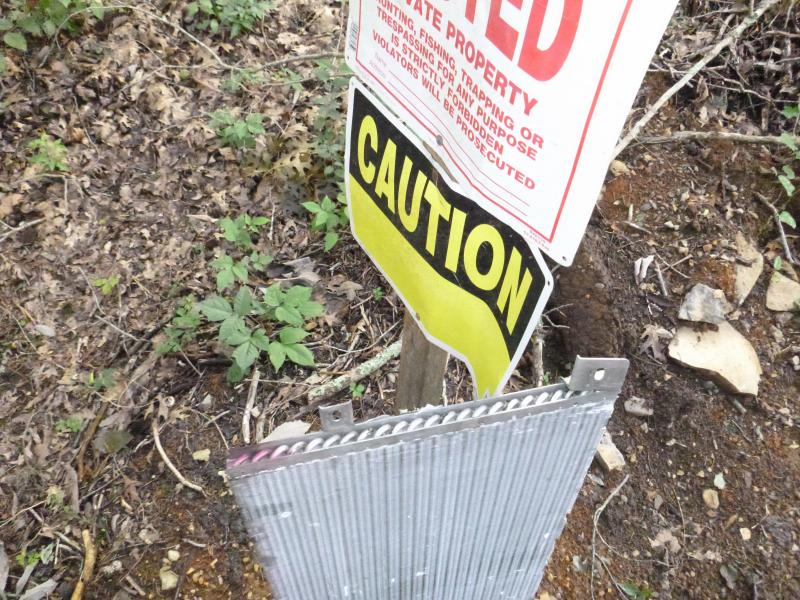

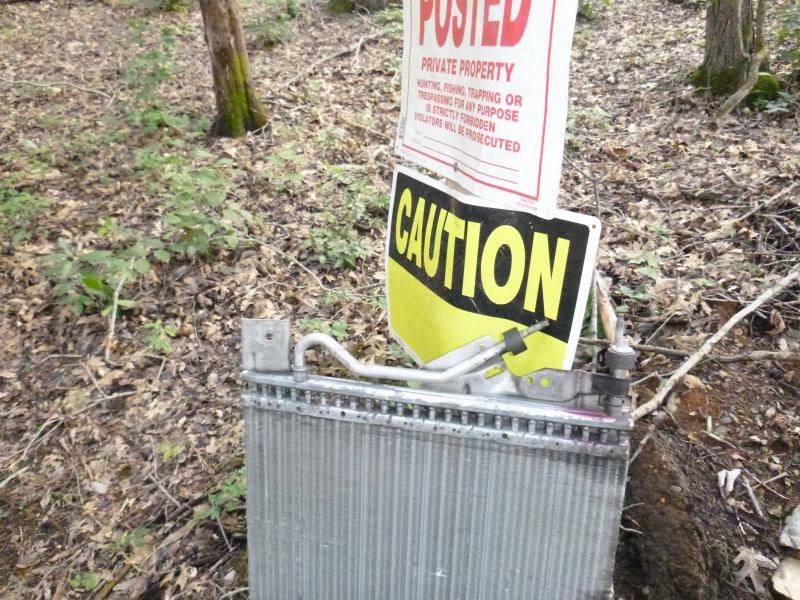

I snapped a few pics of the old condenser.
There are a number of departures on this vehicle. For one, VIN 'S' has the Duratec engine, not Ford Vulcan.They remind me of the Taurus SHO's from the 90's in that, you might find one that has a supercharger, or some luxury feature you wont see on standard models. I'm not talking it up, but I often find information on 04 Taurus' that dont apply to this vehicle.
I will check the manual about the cabin filter. Its possible. My Jeep is the top of the line trim package, and it has the capacity for a cabin air filter, but they are not supplied, even new. True efin story. Owner must install it, at own expense. little over $100 I think.
Anyway, here are the results. I did in fact add a bit of refrigerant.
Ambient Temp: 86 deg F
Test Time: 5 minutes
Low Pressure: 31-36 PSI
HIgh Pressure: 245-290 PSI
Vent Temperature: 62 degrees F
R134a Chart:
Ambiant 85 deg F
Low Pressure: 45-55 PSI
High Pressure: 225-250 PSI

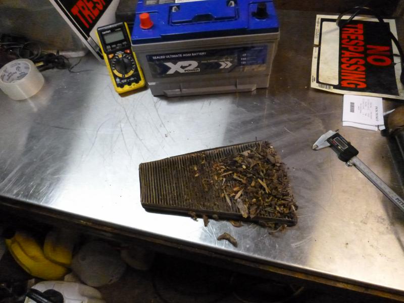

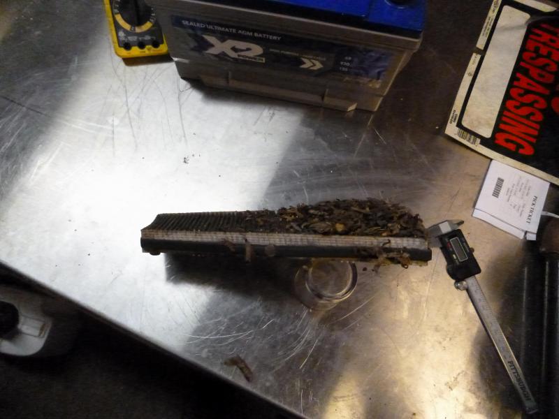

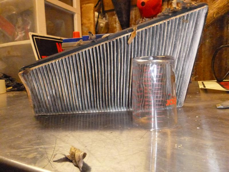

Not sure why you keep on about the cabin air filter? Looks fine to me
Seriously, It may be moot with regard to the AC . This vehicle has not discreet recirc control. There is MAX AC, and AC. Max is recirc, while AC is fresh air. You can believe that that and the passenger side gas fill tube are my favorite features on the vehicle.
Of course I must perform the test again. I go to the city on thursday to the doctor, I will try to obtain another infrared thermometer to read the pipe temp.
Thanks for the heads up. It was in fact on the 15k mile checklist. I probably saw it and though it was not equipped.
When I was a kid AC in a car was sticking your head out of the window. Not that cars didnt have AC, but they were usually broken, or the driver didnt want to spend extra fuel to run the AC. I can understand. At .59 cents a gallon, who wants to lose 3 mpg to stay cool when its 95 deg outside?

Looks pretty nasty!
A lo of 31 psi means the core is at 36°. Allowing for some loss with the heat transfer, your vent temp s/b close to 40-42°
Would be interesting, and helpful to future readers, if you could post your numbers again.
Given the two choices you have, we need the numbers on whatever your recirc is.
I believe your condenser is the piccolo type. Should be OK
Be sure to get the air filter for your Jeep, else your evap will clog up beyond repair. We have changed out several such evaps. A not fun job and very labor intensive
