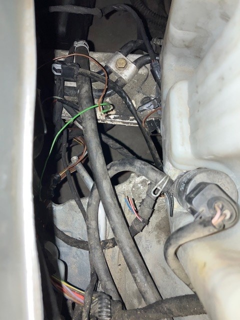

The car was maintained beautifully except that it was involved in a small accident a few years ago and the RD was removed and the two pipe going to it were cut off and not capped.

The condenser is not damaged. Not sure what kind of accident would lead to what I'm looking at...the receiver dryer is like torn out. The aluminum pipe part of the hoses near the RD are broken off as though it was in an accident. The open ends are relatively protected under the hood but are not capped from atmosphere.

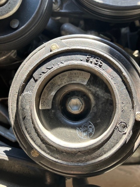

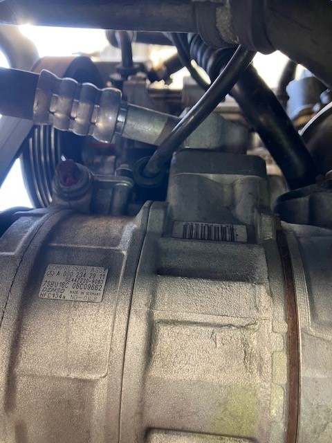

From what I've been able to determine, both direct-drive and clutch-equipped compressors were installed on these cars when new. To be sure which one you have, look closely at the wiring that goes to your compressor. Both types of compressors will appear essentially the same except that on the direct-drive compressor, the wiring from the controller goes to the back of the compressor and to the control valve instead of to the front of the compressor as on the clutch-equipped unit.erubin wrote: Tue Jul 05, 2022 2:16 am I can spin the nose of the compressor by hand with the belt attached. So that means I have a clutch on my compressor.

Thank you John. Here are photos of the compressor. You can see that the wire goes to the middle but when I look up the Denso number it says clutch.
- compressor front.jpg (102.66 KiB) Viewed 15844 times
- compressor side.jpg (96.29 KiB) Viewed 15844 times

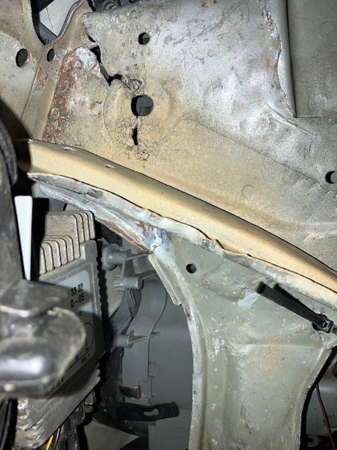

Here is a view from beneath the car with missing RD. You can see some damaged metal with a few sloppy welds. Amazingly its the only sign of damage. The radiator support is perfect and factory original and the fender looks original with no paint overspray anywhere to be found. Its as though the damage only destroyed the RD and the car frame holding it. The second photo is taken from above. The electrical connector for the RD mounted temperature switch is intact but the RD mounted Blade type; 3-prong electrical connector is missing. I do se two sets of wires dangling in there, one is a green and a brown wire and the other severed wire pair is red/white and blue/brown stripped. Maybe I need to keep looking for the pressure switch 3-wire if it's not these?
