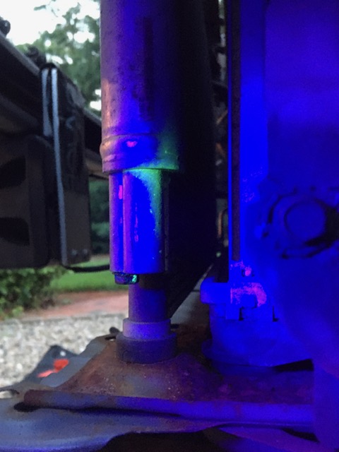

Thinking that I had a leak, I pulled front fascia off car to better shine my UV light (already had this in my arsenal of tools) and discovered leaks at lower condenser connections (one at receiver / dryer) and one at output line connection. See photos of florescent dye tracks. No other leaks were detected -- none on lines, none at compressor, none at ports, none anywhere else on condenser including fins and none at drip tube of evaporator or water droplets from evaporator). So I bought a can of pure r134a (no additives) and a set of yellow jacket manifold gauges/hoses.

Couple of thoughts:
Fix the leaks first.

Re: 1st Post Need Help Honda Fit A/C Issue
You are wasting your time unless the leaks are fixed.
Absolutely agree. Always fix first what you KNOW is bad.
Yes, I certainly will be fixing the leaks (and installing new rec/drier) before any other potential actions. And, of course, the truth is that I have no idea as to how much refrigerant is in the system now. Still, it does seem meaningful that suction side pressure is normal while discharge is very low. I do suspect that ultimately we will find a compressor-related problem. I'll be back once leaks are fixed, new rec/drier is in place and system has been recharged. Thanks in the meantime.
