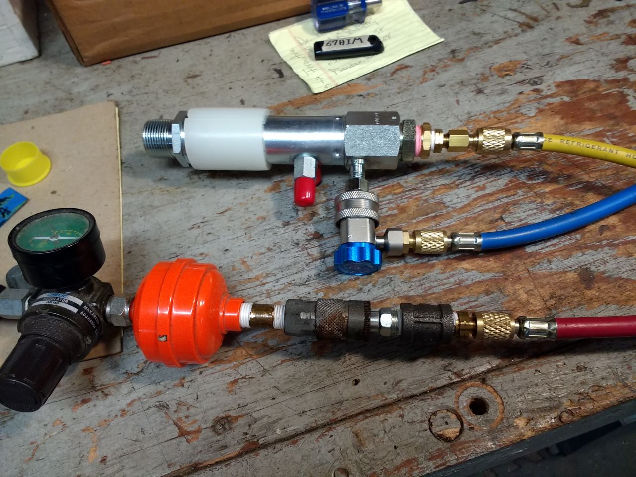

Tried to test the poa valve today. i set up the test rig as per the paper that has been referenced and posted here many times. the shop air is run through a drier and regulated to 75psi. as soon as i crack the high side valve on the manifold i can here air bleeding through the poa valve, there is no "pop". what am i missing. thanks.
POA Test Rig
POA Test Rig
Posts: 1427
Re: POA Valve Test/Adjust
I'm not the POA guy. I would think any sound of leaking air is just that. If air leaks, I would refrigerant would also.
