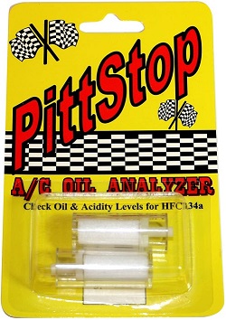

I use a product called Pittstop to estimate the quantity of oil in the AC system. I have another car and when the compressor was replaced in this other car, the entire AC system was flushed (removing, hopefully, the vast majority of the oil). So we knew how much oil we put back in the AC system and Pittstop indicated that the quantity of oil was fine, which was what we expected. But this is the only information on the accuracy of Pittstop that I have.JohnHere wrote: Mon Jun 07, 2021 10:22 pm You are correct in that the specs for your vehicle call for 5 fluid ounces of oil, PAG-46 in this instance. Additionally, 18 ounces net weight of R-134a are required for a full charge.

On my Civic, before the compressor replacement, Pittstop was showing a very low quantity of oil in the system, which I thought it was possible, because refrigerant had been added to the AC system in a couple of occasions (because of leaks) without adding oil.
When the compressor was replaced, the new compressor came with 3 fluid ounces of oil and we did not add any other oil, because the shop estimated that there were other 2 fluid ounces distributed in the AC system. Pittstop, however, is now still showing a very low quantity of oil, just a tad more than what it was showing with the old compressor. The AC system was not flushed before installing the new compressor.

• As stated, Pittstop reads very low quantity of oil

I think you need to mention Pittstop at least once more so we know you used Pitsstop!
