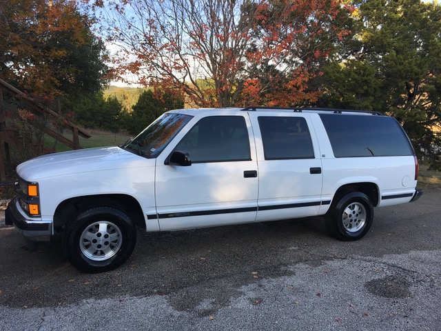

Photo of 1995 Suburban. 145k miles. I'm the second owner.
