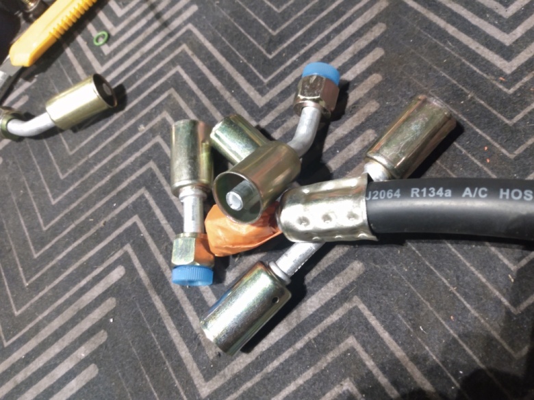

Here is a pic of the connectors, what really got my attention was the asymmetrical crimp which I did not have when I did the #8 hoses.
Tim: I am going to make an order for a few connectors (edit no hose because of the min.) since the project has ground to a halt anyway I have time to consider my options.
I may end up having to scrap all the hose and connectors I have and start over...

I don't remember anymore whether you made mention earlier in this very long thread, but I believe you can go with either a 5/16" ID (7.9375 mm) reduced barrier or standard barrier hose, each of which, IIRC, takes industry-standard 3/8" (9.525 mm) fittings. The only measurable difference between the two hoses is the outside diameter (OD). Seems like either hose would solve the problem when used with the correct, properly dimensioned fittings.
Re: Newbie, installing "custom" system
I am using all standard barrier fittings and hose.JohnHere wrote: Mon Feb 05, 2024 11:10 am I don't remember anymore whether you made mention earlier in this very long thread, but I believe you can go with either a 5/16" ID (7.9375 mm) reduced barrier or standard barrier hose, each of which, IIRC, takes industry-standard 3/8" (9.525 mm) fittings. The only measurable difference between the two hoses is the outside diameter (OD). Seems like either hose would solve the problem when used with the correct, properly dimensioned fittings.
- Posts: 1834
No chance of any sub-standard, out-of-spec fittings to which Tim alluded earlier? Not trying to give you a hard time, just attempting to get to the bottom of this.
To review: For a standard 5/16" (7.9375 mm) ID barrier hose, the fittings should measure—according to my Mitutoyo digital caliper—3/8" (9.525 mm) OD—that is, 1/16" (0.0625 mm) larger than the ID of the hose to ensure a tight fit before crimping.
