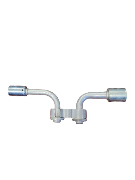

Thanks for making me look deeper. Found these promising solutions. They are promising because I could leave the compressor vertical.
I'll contact the source(s) if they would work on the FS10 since from some sources indicate they fit GM systems some say just 3/4" and 7/8".
Is 3/4" #8 and 7/8" #10?
Option 1 - "Universal Compressor Swivel Manifold with 3-4" Discharge x 7-8" Suction Ports"
I like this one because it would be short (height wise) and I could go directly to the right on the right port and then on the left port align it 45deg angle and put on a 45deg fitting and both would go nice and flat to the right.
Or get these separate units and make my own back/press plate.

Option 2 - not clear yet what the overall height is. (I'll be asking) It would have the advantage of combining the block and hose fitting.
