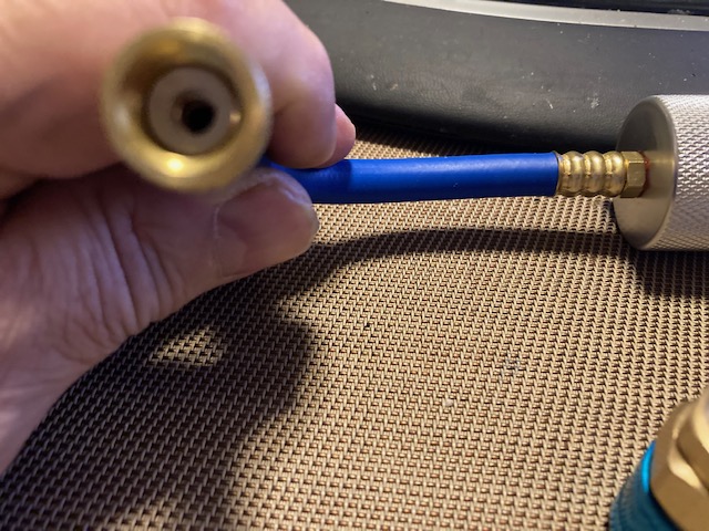

OK, Iguess what I got ain't gonna work. There seems to be something missing in the end of the hose.
- tube.jpg (149.32 KiB) Viewed 11550 times
when I screw this onto the threade connector on the liquid line, don't I need the pin inside the end of this?
Posted: Mon Dec 19, 2022 8:28 pm
Yes, that end is supposed to have a valve core depressor in it. ?Chinese?

Without the depressor it is not useable
" and open the high side valve on gauge?"
If by this you mean open the high side handwheel on your MGS, then no. That will not accomplish anything.
As JohnHere states, the vacuum in the system will suck the oil into the system. You don't need the MGS for this at all
You spent a good amount of change on the Appion, so a proper oil injector is far less. It is difficult to do AC work without proper tools.
Suggest a reputable brand such as Yellow Jacket. They make all manner of tools, equipment, hoses, fittings, etc for the industry
