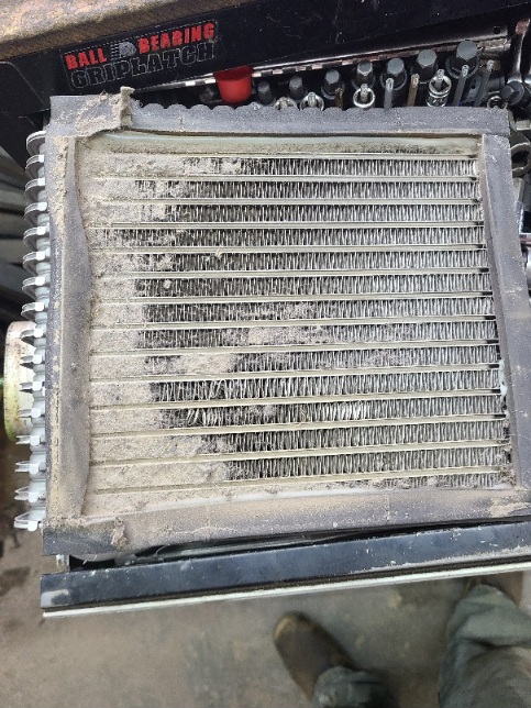

Front evap was clean, not hardly any dust buildup. Rear was a little dirty, but could have been much worse. And probably will be after a few years with the dogs. Fans mounted up nicely, and just need to have the wiring finished.

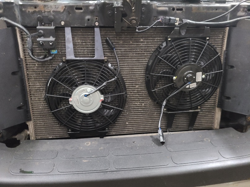

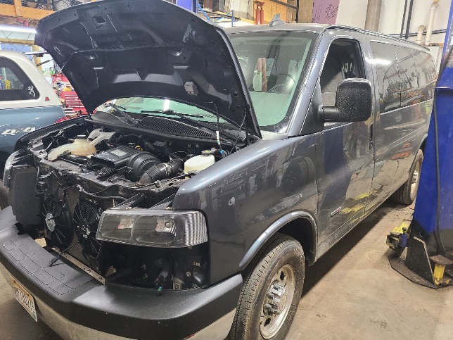

Here are the fans mounted. And the rear evap before I cleaned it.

It doesn’t take much crud on an evap to reduce performance. Keep an eye on it, there will be mega dog hair on it soon enough.

Sounds like you made good headway. Fan install also looks good. Almost like they should have been there from the factory. I have both of my fans on the bottom rows of the condenser vs your offset mounting. Probably tomato vs tomatoe but I made the assumption the condenser was hottest at the top and to me made more sense to further cool the refrigerant after it liquified by pushing more cfm through the already cooled off area of the condenser. My fan mounting was also dictated by the transmisison cooler and are mounted to the edge of the condenser only because it has an 11" wide, 10.5" tall transmission cooler mounted dead center biased toward the top. Low mount gave me more space for the fans width under the cooler. I used insert rivet nuts myself on the upper mounting bolts but elected to use self tappers on the bottom into the plastic of the core support. Would have had to pull the bumper or core support otherwise. I run my fans off a relay tied into the orange trigger wire for the front blower relay. I find that on cooler days or on the highway when less than full front blower speed is needed to keep the interior cool there is little reason for the fans to run. On a hot day, idling around town the front blower is on high speed and the fans turn on. Saves wear and tear on the alternator and fans when they are not needed due to lower cooling demands.
One thing I do need to add to my 97 van is those nice air guides GM started adding to the later vans to guide airflow through the cooling stack rather than allowing air to pass through the headlight openings. Mine recirculates a fair bit of hot air from the engine compartment back through the cooling stack through the headlight openings without those fins as well. I actually forgot to ask if your van had those air guides but picture makes it clear that it does. I wish those factory air guides had been longer and reached all the way below the bumper. Shut the hood and you will find a fair bit of hot air still makes its way back in front of the condenser. I have considered buying 2 pair from the wrecking yards, epoxying them together for more length and triming just enough to clear the bumper. My 97 now has a plastic guide at the bottom of the core support as well to help prevent hot air from entering from the bottom. When I first got my hands on my 97 it was missing may have been built without it for all I know, noticed the piece in a later 01/02 van and snagged it from the treasure yard. Made an immediate difference. I also gave a GMC grille for my Chevy to swap at some point as well. The GMC design is much more open than the Chevy design. Painting the GMC grille and installing it is on my list of things to do someday.
