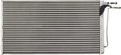

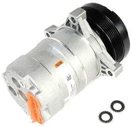

Can I use the Camaro Z28 Compressor with the Caprice AC manifold hoses as shown in the picture I previously posted?
Should I start the process all over and get the AC compressor #15-22135A and the Condenser for the Caprice whic looks like the ones in the pictures below?

Re: AC HOSES
Your compressor will be fine. Looks like both cars used some variant of the H_6 series. HD6, HT6 etc.
The Caprice condenser would be much easier to make hoses for. It uses standard male O ring fittings that are available everywhere.
The one thing about the mid 1990's big GM condensers is they used the same size fitting in and out. In this case, both are -8 size. As long as you connect the liquid line to the bottom fitting - the one that connects to the bottom of the condenser you are good.

Re: AC HOSES
The parts I need to complete the AC system is the line that goes to the top of the condenser to the corresponding Receiver/Dryer.
I have been searching the internet for the past 24 hours for GM part # 10269581 or AC Delco #15-33132 and it is NLA. No one has this line.
Does anyone on the forum have a used one that I can purchase?
The other option is to replace the condenser with the one in the picture I posted for the Caprice.

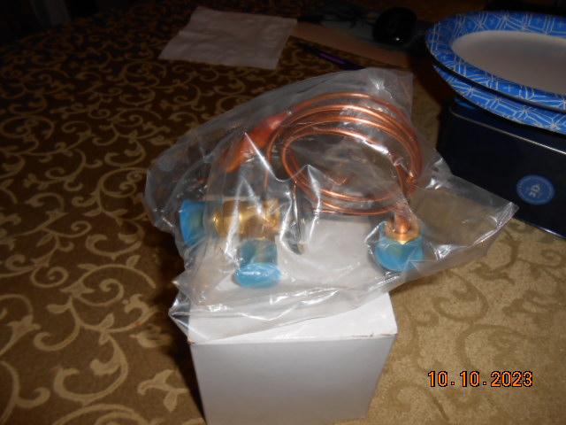

That would depend on your expansion valve. My parts list for that Jaguar shows a brass, right angle externally equalized expansion valve.
Later models had the H type aluminum expansion valve with both the liquid and suction line connections. Which valve does your car have?
We don't rely on OEM hoses for engine swaps. We make hoses to fit the need. Any hose shop should be able to do this for you. The liquid line from that Caprice condenser would be a -8 fitting to a -6 hose at the condenser, and a -6 fitting on the other end. You should be using a standard receiver / dryer like this:

Re: AC HOSES
Yes. It is a brass, right angle externally equalized expansion valve.

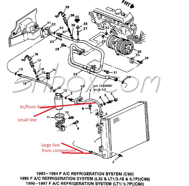

Re: AC HOSES
sanchez wrote: Fri Oct 20, 2023 6:18 am ....condenser has the discharge line from the compressor connected to the bottom of the condenser and the Liquid line connected from the expansion valve to the top of the condenser .....
* Discharge line from the Compressor to the large port (Bottom) of the condenser....
* Liquid line from the expansion valve to the top of the condenser ....
* The dryer inlet side is connected to the smaller line coming from the top of the condenser then goes to the Expansion valve.
The above indicate the condenser is installed upside down.
Condenser has its larger/vapor connection on top and the smaller/liquid connection on bottom. Its a gravity thing.
sanchez wrote: Fri Oct 20, 2023 6:18 am * Suction line from Compressor to Expansion Valve/Evaporator.
This is written confusingly since the suction side of the compressor does not go to the expansion valve. The expansion valve is on the evaporator, on the "in" end but the suction side of the compressor is connected to the "out/exit" side of the evaporator which is a larger fitting size.
Re: AC HOSES
It may be confusing because I don't know the terminology. So here we go again.
Low side from compressor to evaporator.
Discharge line from compressor to bottom of condenser.
Liquid line from evaporator to condenser.
Attached is the AC schematic for the Camaro

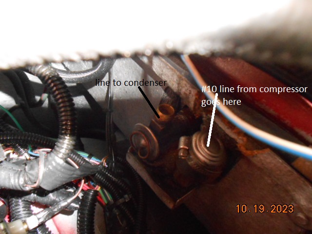

Re: AC HOSES
Here is a pic of the Expansion valve on my car
