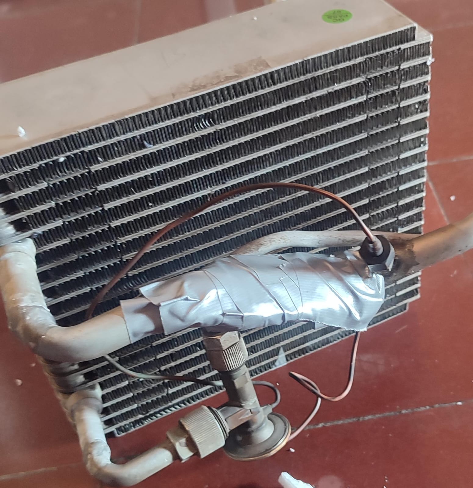

I have a TXV with a sensing bulb, I remember that when the people on the AC shop putted all together they get the TXV from an old car they had around, so all the AC components where new, but the TXV no. So I always wanted to change the TXV for that reason, but again, I don't have a lot of knowledge about this specific part, so I don't know how to tell if it is working good. Someone told me that you can adjust TXVs, do you think that could help?.JohnHere wrote: Thu Sep 28, 2023 6:58 am In your first post, the low-side pressure was 36 PSI, which means that your evaporator is running 40°F or a bit higher, too warm for decent cooling.
What kind of TXV does your Civic have, a block-type or one having a sensing bulb?
- QAS.jpeg (249.14 KiB) Viewed 16037 times

A couple of issues come to mind about the TXV. The first is that we don't know for certain whether the TXV the shop installed is any good. The second is that the sensing bulb is wrapped in what looks to me like duct tape, which isn't sufficient as far as insulating properties are concerned. It's likely that the sensing bulb is picking up heat from the engine compartment. If that's the case, then the TXV won't get the correct signals to operate properly. And hence, your A/C system won't work right. I wouldn't suggest that you try adjusting it, either.
If the car were mine, I would replace the TXV with a new one from Honda. The reason I say that is because over the past few years, some aftermarket TXV's have been known to give problems, requiring that the job be done over, which I'm sure you want to avoid. Additionally, you'll need to ensure that the sensing bulb is securely fastened to the suction-side tube using the original clip(s), and that it's well insulated. The pros use a product called Prestite Tape, which you can probably get locally from an HVAC supplier in your country.
To replace the TXV, you'll have to recover the system so that there's zero pressure in it.

Yes the sensing bulb is attached with the original clips, and they said that the TXV is an OEM one they got from a civic or prelude, I don't remember, but of course it was used, and yes it is just wrapped with aluminum tape and duct tape, so I guess I will have to get some of that Prestite Tape.JohnHere wrote: Thu Sep 28, 2023 10:51 am A couple of issues come to mind about the TXV. The first is that we don't know for certain whether the TXV the shop installed is any good. The second is that the sensing bulb is wrapped in what looks to me like duct tape, which most likely isn't sufficient as far as insulating properties are concerned. It's likely that the sensing bulb is picking up heat from the engine compartment. If that's the case, then the TXV won't get the correct signals to operate properly. And hence, your A/C system won't work right. I wouldn't suggest that you try adjusting it, either.
Talking about the TXV, is there a way of testing if it is deffective?, It would be better to modify the lines and to install a block TXV, or just to replace it with the same type of TXV
If only we had professionals like you all in my country, I would not be in this nightmare.

4. It is difficult to determine if the TXV is any good. That is why John is suggesting that you get a new one. And, yes, the bulb must be insulated. If it is wrapped in aluminum tape, that is only going to ADD heat to it, and not insulate it.
