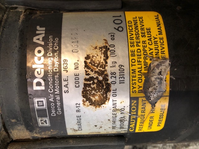

It says 10 fl. oz on the new compressor sticker label.
So if I am able to drain 10 oz PAG from the new compressor, I should refill with 10 oz mineral?
On my old compressor, it also says it contains 10 oz. See pictures.
So it doesn’t matter how much oil that’s being drained from the old compressor?

For all practical purposes, yes. Although a very small amount--maybe 1/4 of an ounce--of mineral oil will remain in the compressor after you flush it, putting in a full 10 ounces--perhap a 1/4-ounce over-fill at that point--won't make a difference.jllgd wrote: Sat Apr 23, 2022 8:35 pm It says 10 fl. oz on the new compressor sticker label.
