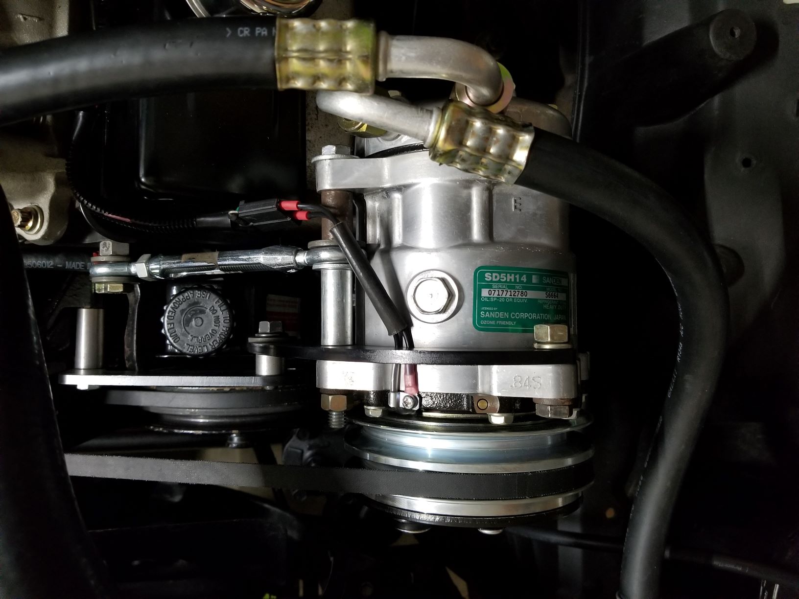

This is how I have the turnbuckle attached. I set the belt tension first. Then preloaded the turnbuckle slightly.
After purchasing the Alan Grove bracket I noticed another bracket I could have bought that has a turnbuckle included but attaches to slightly different points on the head.
I read that Sanden recommends no more than .006" ear deflection due to breakage and leaks. I set up the spacers you see on top with no slack between the ears before tightening the bolt. I had to shim the bottom mount as well with a steel shim that was about .020" to get no play as well when I first installed the compressor.

I also plan on getting a higher quality turnbuckle in the future.
The turnbuckle you see is an el cheapo from the hardware store and was for experimentation purposes.

Re: Minimum compressor RPM
Stress in that direction is much better, It's the pulling in or pushing the ear out (horizontally ) for no better term.
