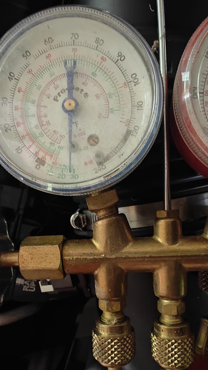

In your first photo, I see only about 26 inHg on the LS gauge. Was this reading after you let it set for 48 hours, or during evacuation? If it was during evacuation, that gauge reading suggests contaminated vacuum pump oil, a defective vacuum pump, or you live at a high elevation, in which case 26 inHg would probably be normal. Is the gauge itself zeroed?
Its a home gauge ( my son is in hvac and his vac pump didn't have a fitting for my auto gauges.) That reading is after 48 hours, it was at 30 during vacuum.

Ex313 wrote: Wed Aug 06, 2025 8:19 pm Its a home gauge ( my son is in hvac and his vac pump didn't have a fitting for my auto gauges.) That reading is after 48 hours, it was at 30 during vacuum.
Okay, that explains the gauge being calibrated for R-12, R-22, and R-502 but not for R-134a.
If the gauge read ~30 inHg during evacuation, that's good. But it must have lost vacuum during the 48 hours you let it set because the gauge now appears to read ~26 inHg. The discrepancy might be due to outgassing, a leak, or an uncalibrated (zeroed) gauge.

The discrepancy might be due to outgassing, a leak, or an uncalibrated (zeroed) gauge. OR a vacuum driven so-called vacuum "pump" such as you can buy at Horrible Fright was used. These devices are a joke because they CANNOT attain sufficient vacuum.
