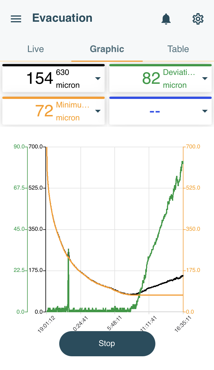

I pulled a vacuum overnight to try to hit <100 microns as recommended by some experts. I woke up to see the image below. As you can see, the vacuum initially went great, reaching 72 microns (measured at the high side with the vacuum on the low side). However, at that point, the system suddenly began to lose vacuum, going up to about 150 microns before I stopped the process to think about the next step. Subsequent vacuum attempts will not go lower than about 250 microns, even after leaving the vacuum pump on for over 24 hours.

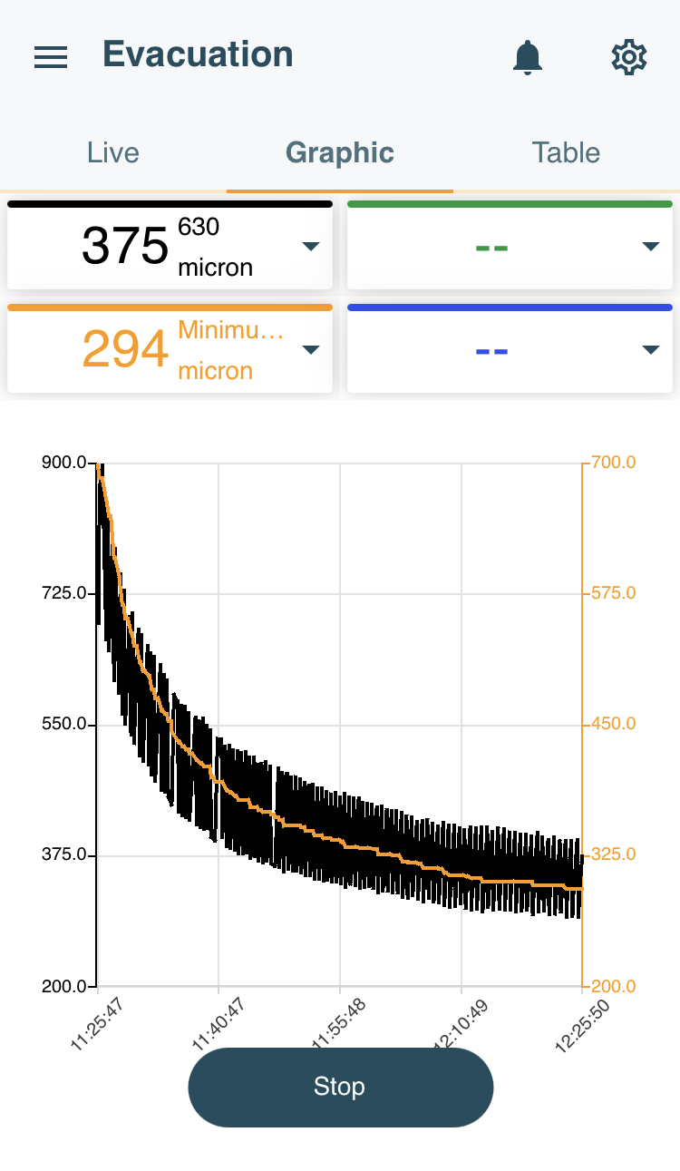

My inexpert guess is that the deep vacuum opened up a weak link in the system and I now have a new leak. I tried replacing all the o-rings (with Nylog) in front of the firewall (but not the ones at the firewall), but I still can't pull below about 250 microns. Also, the vacuum plot now shows a constant ping-pong / up-down / sawtooth micron reading instead of a smooth line (image attached). I think this is also evidence of a tiny leak that constantly opens and closes in response to the vacuum pulling on it. My guess is that this is either a leaking o-ring that I didn't replace (i.e., at the firewall/evaporator), or a pinhole with refrigerant oil covering it that continuously creates a bubble that pops and reforms.

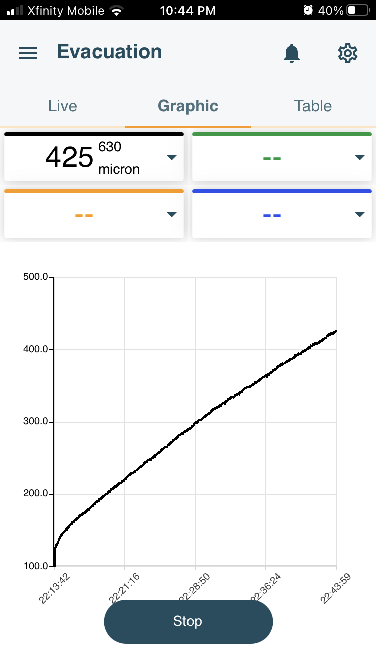

Although my nitrogen pressure tests do not indicate a leak, a 30-minute vacuum leak test strongly suggests a leak, as evidenced by the constant rise in the attached image. The attached image is with the micron gauge on the low side, near the vacuum, so that is why the vacuum appears to have gone so low. For some reason, I don't get the sawtooth pattern when pulling a vacuum this way.

The last image (#3) in my first post above shows the result of the vacuum leak test. With the micron gauge on the low side port, it begins at about 100 microns but rises to nearly 500 microns in 30 minutes. The shape of the rise is linear, indicating a leak as visually explained by Jim Bergman here:
https://youtu.be/sczq-I1Nfjk?si=rrVNxsyUqX3sTUFK&t=684
If I had outgassing / moisture in the system, I would see a curvilinear rise, not linear. A leak-free system should have no appreciable rise, i.e., a flat line.
