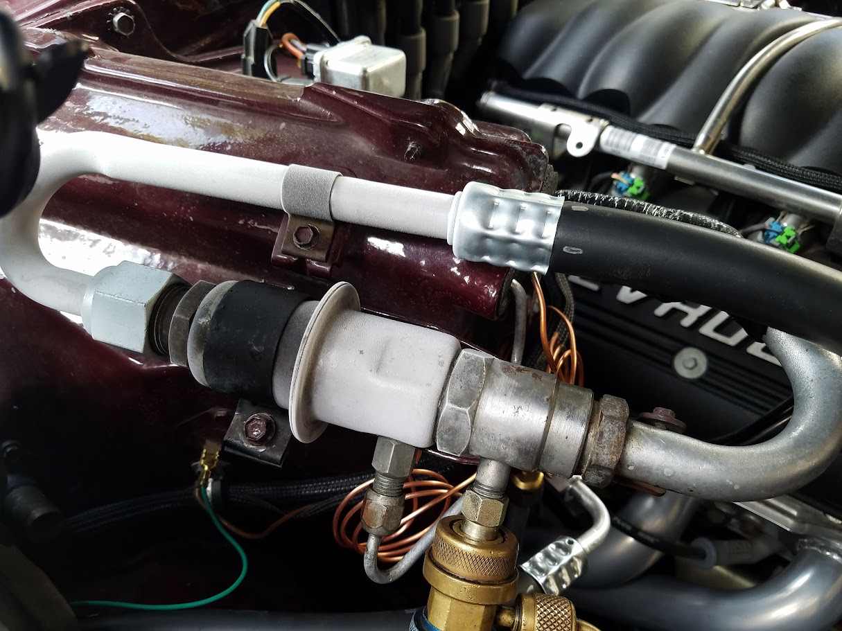

It is normal for frost to form on the second half of the POA valve when it's regulating. That's because the POA will set the minimum evaporator pressure, but down stream the compressor can suck down further which will result in lower temps and frost after the POA. I've attached a photo of my POA valve with frost forming; you can see where it starts just after the regulating area of the POA
The small line from the TXV to the POA valve is a pressure equalizing line. Refrigerant does not normally flow through that line. It just balances pressure from the sensing bulb and a spring to set the superheat. Some systems also have a second oil bleed line that allows a small amount of oil to still circulate even if the POA is mostly closed down; that line is connected to the bottom of the evaporator and it's so small, only a small amount of liquid can pass through it and then evaporate in the second half / downstream of the POA. That can also result in some frost.
I have a GM POA system that I've updated to R134a and a few other things. I have a video that helps explain how the system works, which also has links to other videos showing how to test and adjust the POA valve when converting to R134a. You can find that long explainer here: https://youtu.be/jNUb-GDWz4Y?si=gxk2mC4lnMLtcFBQ
I would get a gauge set on it and if you see normal operating pressures, check other parts of the system like the blend door, heater shut off valve, recirculation ducts etc.
