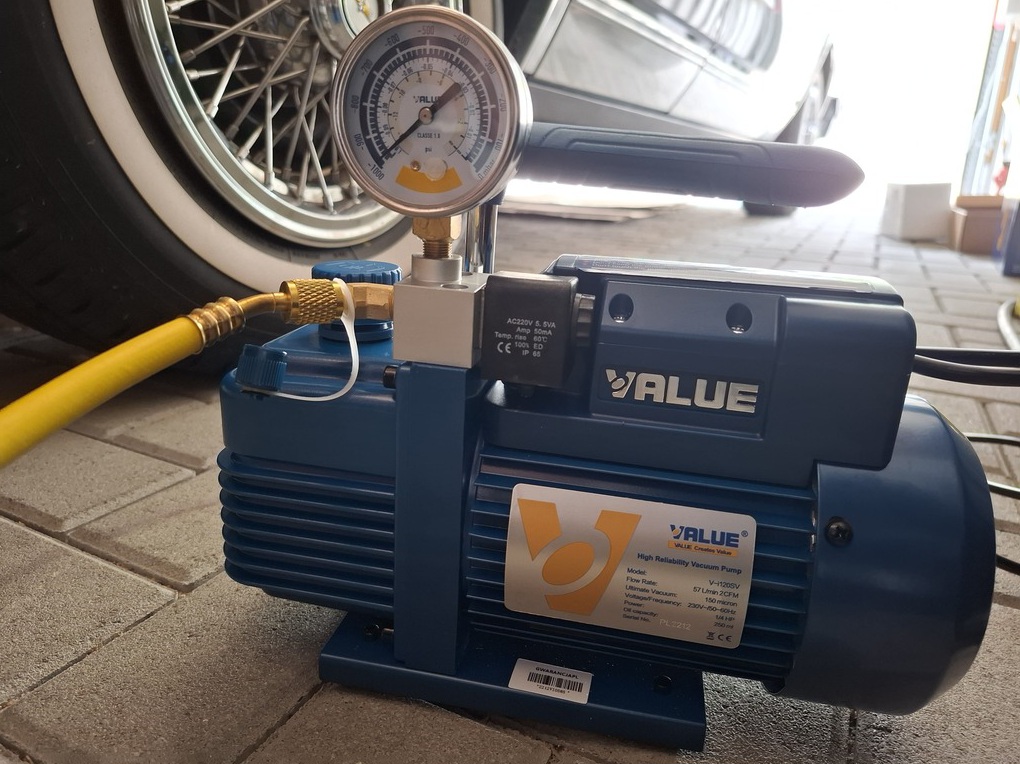

Almost forgot: the vacuum issue.
After alot more research I found another manufacturer of vacuum pumps that seemed to be good. Paid 160€ for it.
For anyone looking in Europe: Value V-i120SV.
Has a vacuum gauge directly mounted to the pump with a proper scale (still not accurate like a micron gauge I know, but better than the small vacuum section on gauge sets). Resolution of the gauge is in 20mbar steps.
And it has a solenoid that closes the port when the pump is switched off so no vacuum can bleed off through the pump.
Did the evacuation myself until there was no rise in vacuum after switching off. First time, vacuum went up a little and then stopped. From what I read, that could have been moisture boiling off. When I was finished, the needle did not move a tiny bit, so I considered that to be okay.
At my elevation, the maximum achievable vacuum was 980mbar and the needle almost touched that point on the scale.
Conclusion: the first two pumps were complete garbage.

Re: Noise after AC service
The pictured vacuum pump appears to be a very high-quality piece and well worth the money. Good work on achieving a vacuum of 980mBar, or 28.9inHg. Given your location above sea level, that's just about the maximum vacuum achievable.
Now that you have a high-quality vacuum pump, don't forget to closely follow the manufacturer's recommended oil-change intervals to achieve the highest possible vacuum each time you use it.
