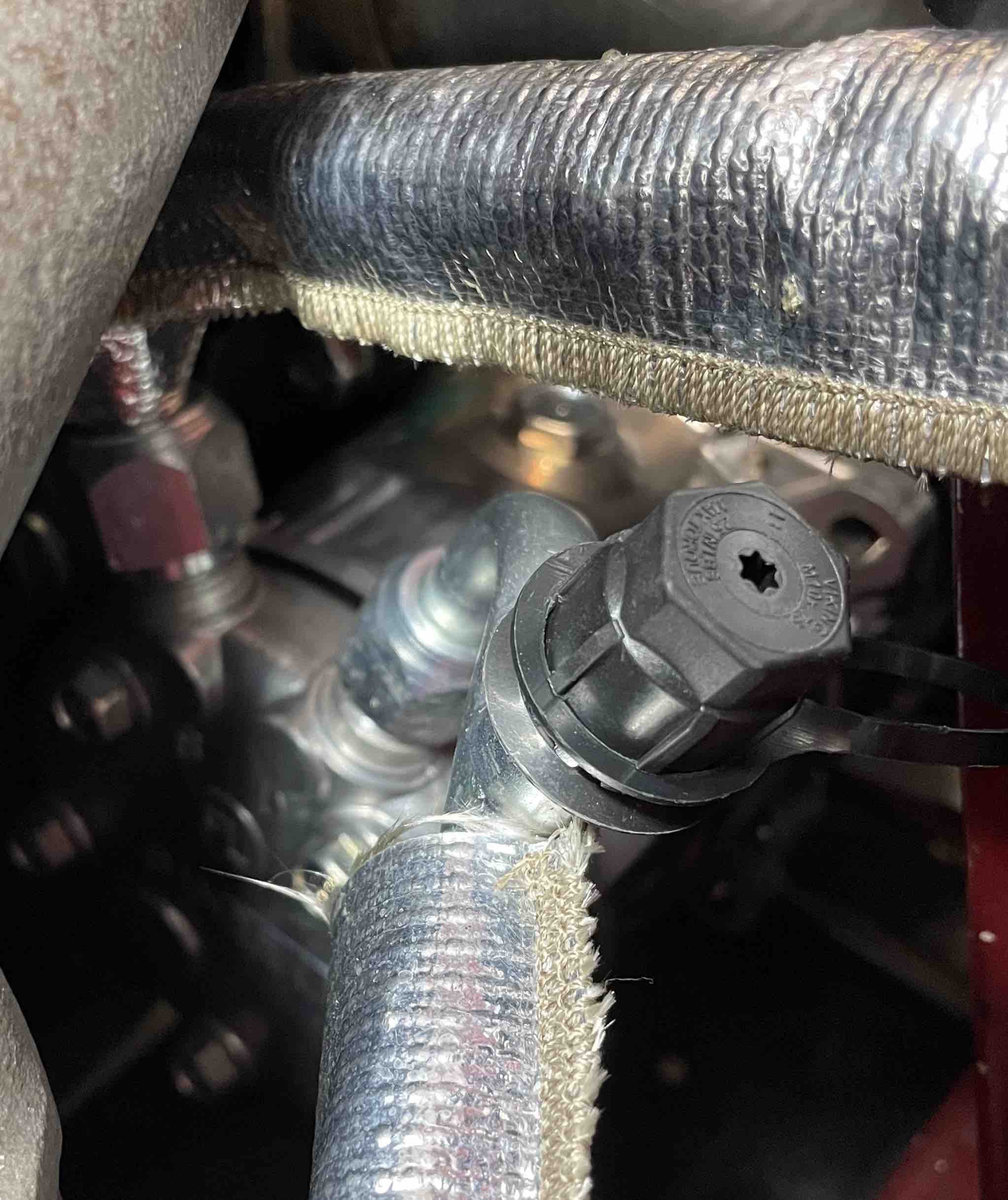

Could having the fittings so close to the 600 degree exhaust manifold cause higher high-side pressure?tbirdtbird wrote: Sun Jul 14, 2024 6:35 am 275 hi at 92F is overcharged.

Re: help interpreting pressure readings
Ya know, for some reason, I am just now seeing this question and pic.
Of course, an AC line being close to exhaust equipment will most assuredly increase the hi side pressure. Or low side pressure.
INSULATE now. We would usually use fiberglass based exhaust wrap, it comes in rolls….have at it!!
We had a guy last summer that had his accumulator and piping right on top of his exhaust who was obviously having trouble with performance. We finally figured it out from pics what was going on. He was mysteriously reluctant to step up to the plate and do the required insulation.
You can have the best engineered system, and if you surround it with exhaust piping and such, it just won’t work. Seems like common sense but he didn’t want to believe us.
