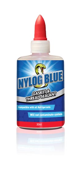

Nylog Blue is made of very thick double-end-capped PAG oil that will facilitate disassembly later should you need to do so, as tbirdtbird said. It's no more difficult to clean up than regular PAG oil. It's used on o-rings and threaded joints and never sets up or hardens.3154tm wrote: Thu Jun 27, 2024 6:21 pm never heard of nylog. i'll give it a try if i find any leaks. how hard is it to disassemble the system after using it? is it difficult to clean up? thanks,
- Nylog Blue.jpg (15.93 KiB) Viewed 21138 times
