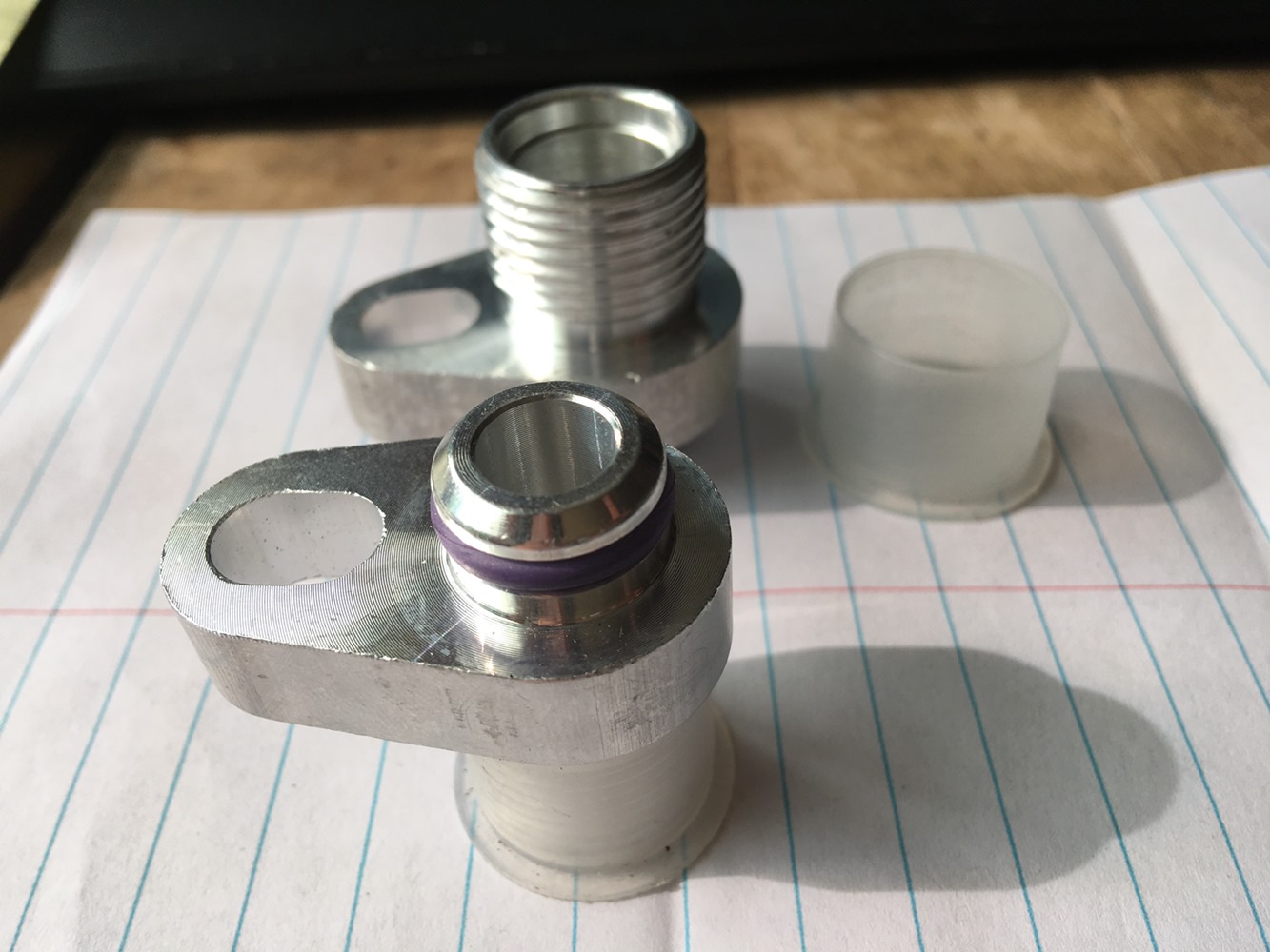

Some folks have cannibalized the pad (manifold?) fittings for the new compressor from hoses for the next gen civic. While that works, it adds clocking of the fittings to the natural bend of the hose, worst for the discharge line since both ends need to be clocked relative to each other. Here’s a pic of those adapters which reduce / eliminate the clocking requirements.
