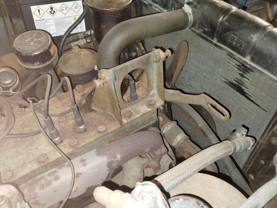

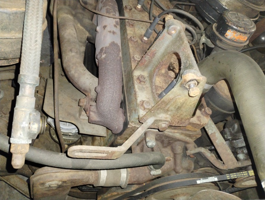

Pics of the original compressor mount.
Earl

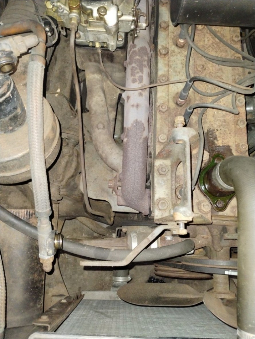

Re: 53 Packard Patrician factory AC
Post by MoparEarl »
One more
Earl
