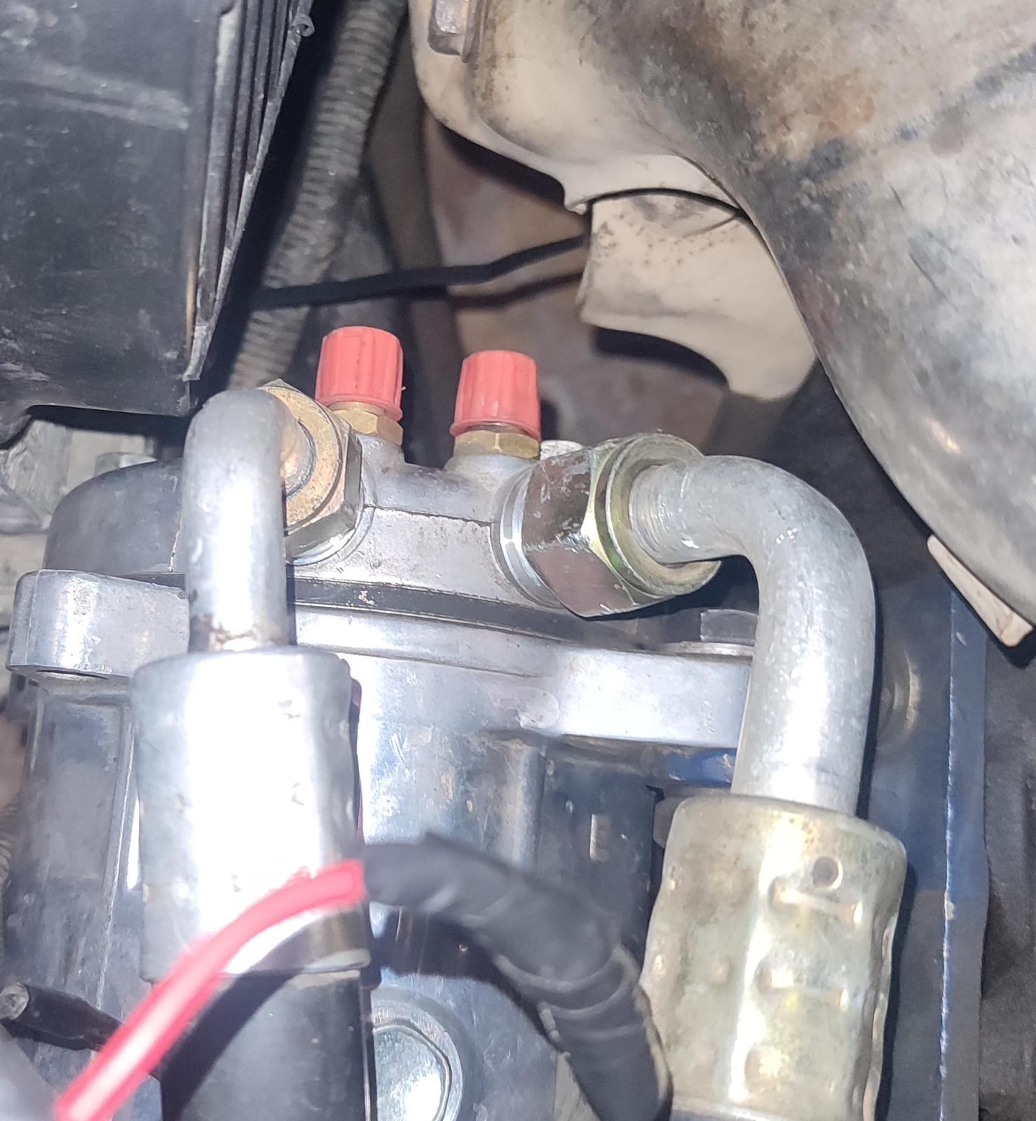

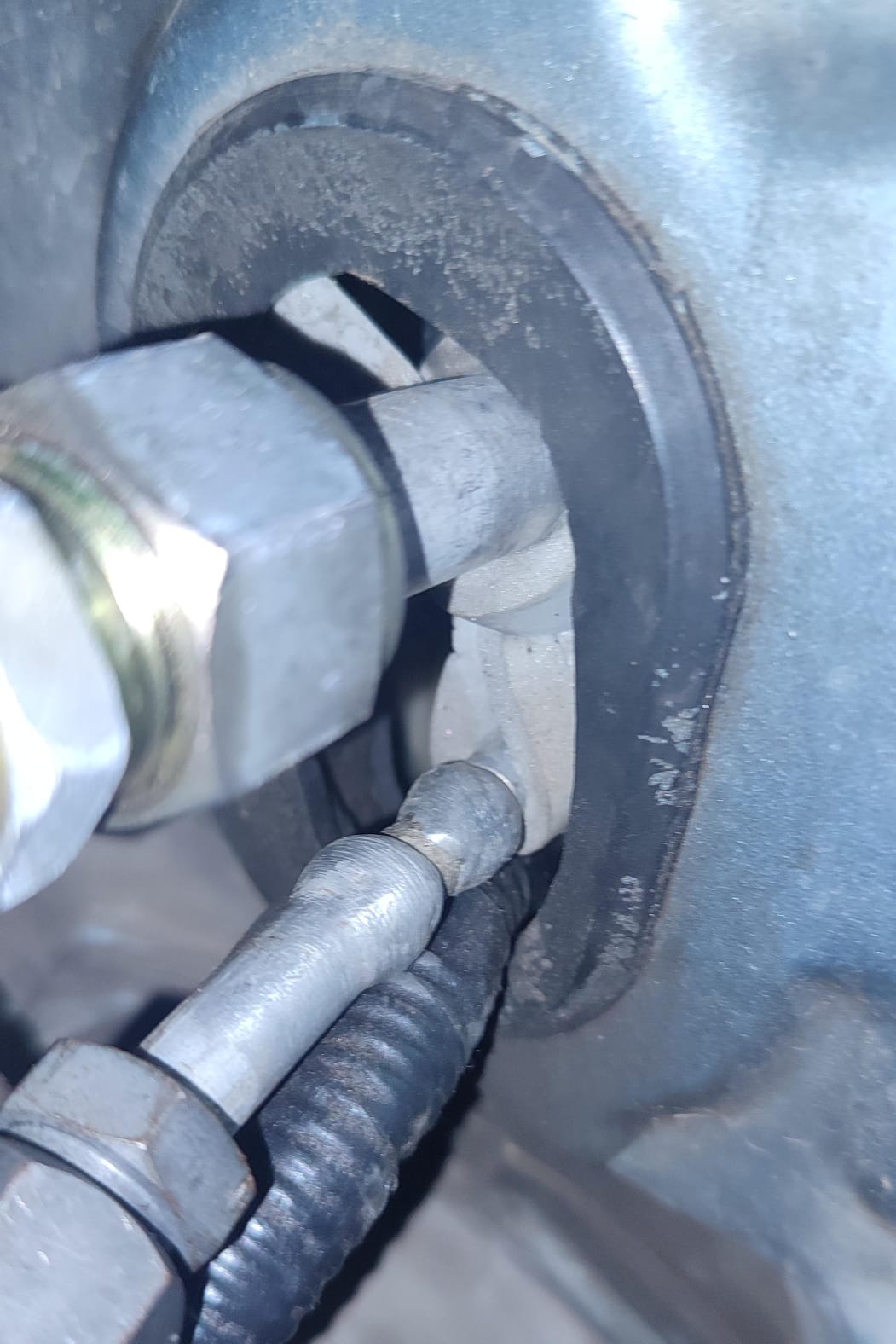

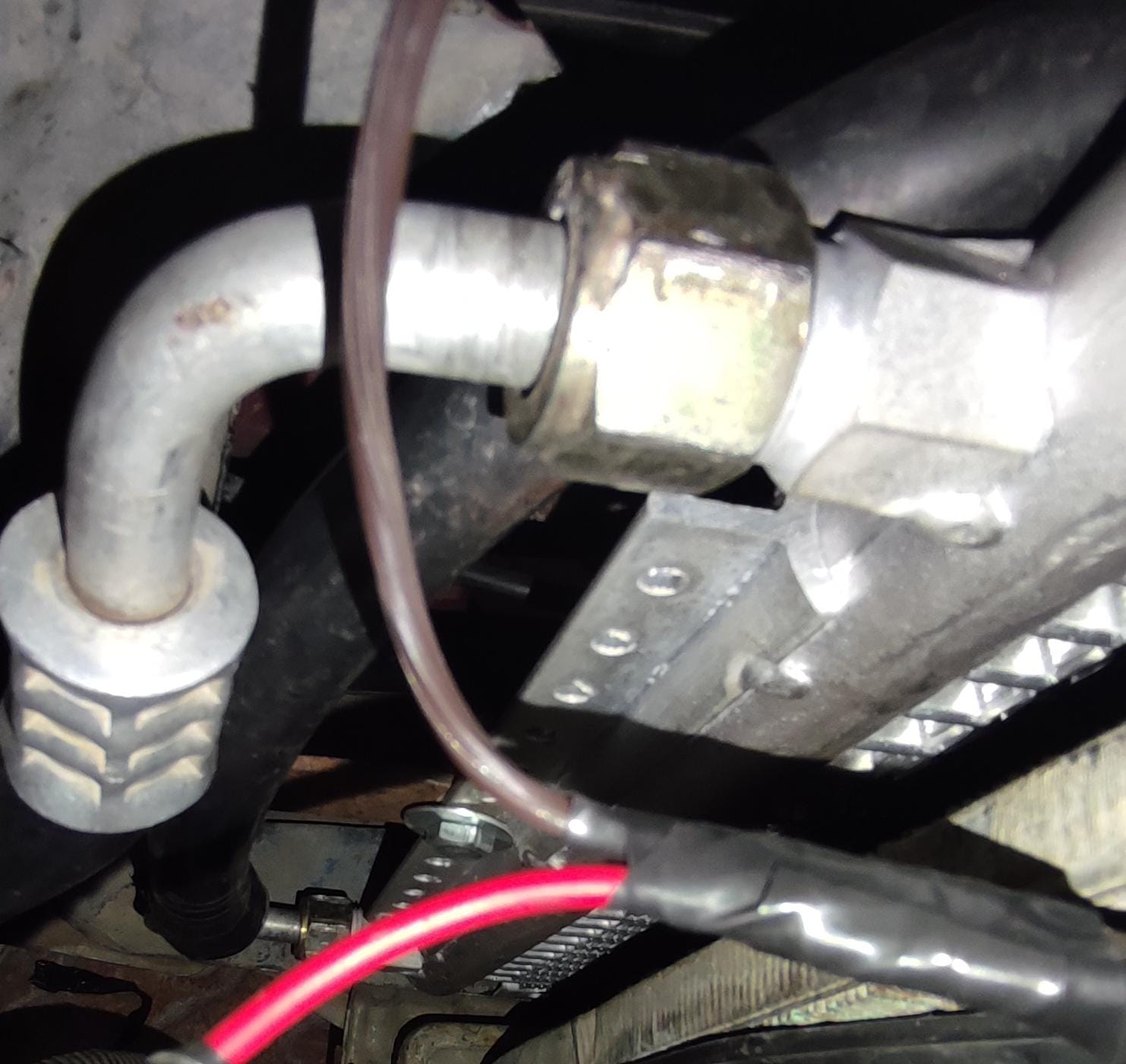

Here are some picture.
#8 at the top #6 at the bottom.
Distance between compressor and exhaust.
Hole in the firewall.

By the way, the picture is not from my actual compressor, because mine is not a V belt, but it is the same chinesse 508.
