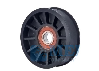

25/225, PF condenser will not change your situation. Muffler just deadends the pumping sound. Over the years, with long belt runs. I installed a backside idler. It stops the belt flap and, in many cases, gets a better wrap on the pulley.

Can you suggest where to go to find an idler for my application ?
The other numbers on the compressor are: CNKJ08 and 10979627.
Re: 77 Pontiac Trans Am 400 V8 A/C vibration issues
Most likely will need to fabricate some mounting hardware. Maybe a hot rod site has one for your specific app.
