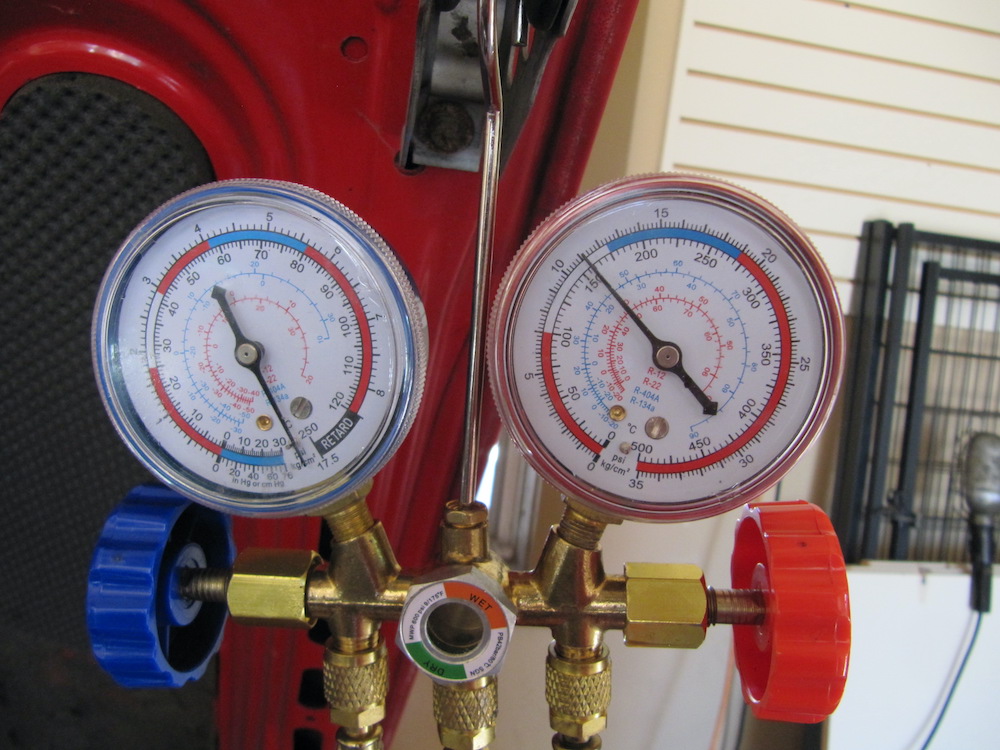

Another data point. It is 80 degrees F this morning. I hooked up the gauges to read the static pressures.
Low and high sides still equalized and each now at 100 psi.
I've understood that static pressures kinda follow F degrees, so I was expecting a little lower.
But when you figure I loaded in 10oz of R-134a when it calls for 28oz, it is a real head scratcher.
My port for the low side is on the return hose downstream of the evaporator to the compressor. The high side port is between the receiver/dryer and expansion valve.
Maybe time to tear it apart, again.
Static Pressure at 80F cold engine

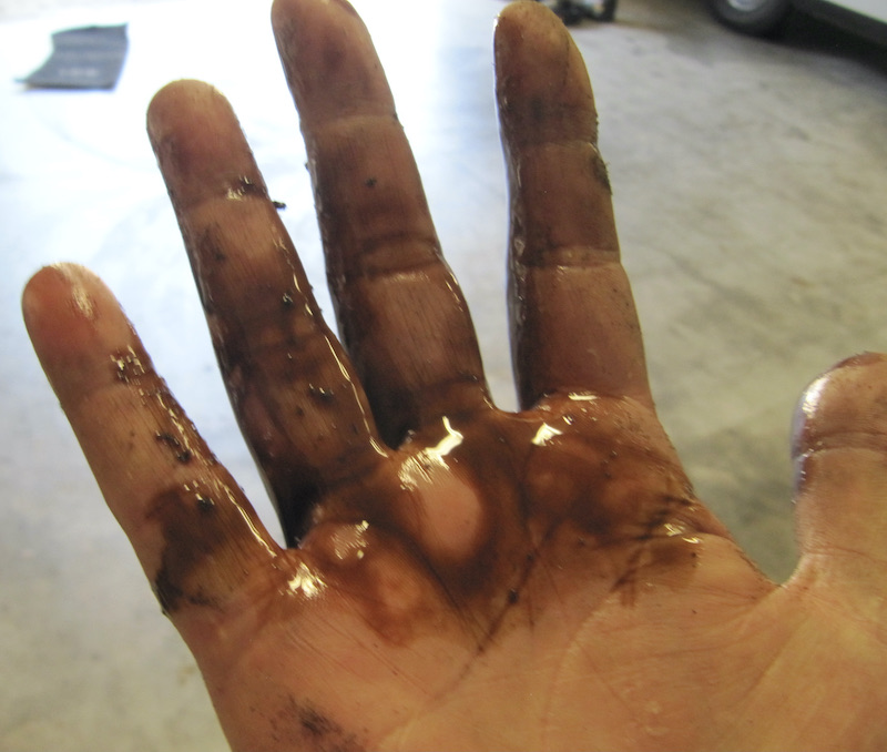

BTW, this is the old [edit] evaporator [/edit] and what came out of it.
Old condenser
Old condenser
IMG_2529 2.JPG (177.78 KiB) Viewed 9805 times
Last edited by LongTallTexan on Thu Jun 29, 2023 10:05 am, edited 1 time in total.
