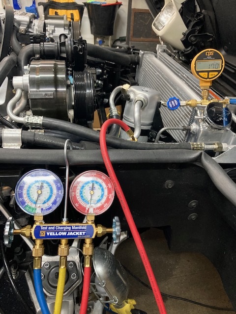

I started pulling a vac at 2:30 and @ 3:00 this is what I ended up with
At 4:30 it was reading 190 microns
When I checked at 7:20 it had risen to 220 microns.
Should I once again puff in about 20 psi of refrigerant and do a leak check with the sniffer and then evacuate again? Also break the vacuum with a small amount of refrigerant, NOT room air?
Yikes!
I am not seeing accum icing. You are under vacuum, so I am not sure how anything could ice. Not sure how you could pull to 170 so quickly, must be a new pump with fresh oil. You did say you were using 3/8 hose tho so that helps, especially with cores removed.

I don't see any icing in the photo. But to achieve a reading of 170 microns after only 30 minutes of pulling a vacuum seems extraordinary and makes me wonder whether the valve between the micron gauge and accumulator is closed.

OK, guys, let me clarify what I got here:
All of my posts from before the hack are history and I’m kinda starting from scratch as to my procedure. Let’s back up to the beginning of this new inquiry starting here:

Tbirdtbird, you suggested that I pull my vacuum from both sides. So:
I am using a New 3 CFM Two Stage Vacuum Pump with fresh oil and my Manifold gauge set connected to both the hi and low ports. I am not using the 3/8” vac line and I have a CPS VG200 Digital Vacuum Gauge connected with a tee to the low side adapter on the accumulator.

JohnHere, you said that to achieve a reading of 170 microns after only 30 minutes of pulling a vacuum seems extraordinary and makes you wonder whether the valve between the micron gauge and accumulator is closed.
I have a right-angle R-134a adapter connected to the port on the accumulator and the valve removed from the accumulator port because the adapter has a valve in it. I also went back and removed the valve from the tee where the gauge is connected.
Try to remember that everything in this system is new but the liquid line and the only oil in the system is the 3 oz in the compressor.
So, here I am back to a completely assembled system:
I started my evacuation last night at 8:00 pm and let it run overnight. When I checked this morning at 9:00 am, I am sitting at 110.
I watched it for 5 minutes and it had rose to 140.
It would seem you are OK. There is nothing shabby about 140 microns
The accum icing John was referring to was during operation, not during vacuuming. I think there was confusion about this, but it seems you are on board.
I am not so sure my comments about low pressure under vacuum make any sense, I was convinced that you were seeing icing on the accum that was not visible in the pic. But I have certainly not ever seen or heard of that.
To some degree you may be over thinking this.
Good luck and keep us posted
