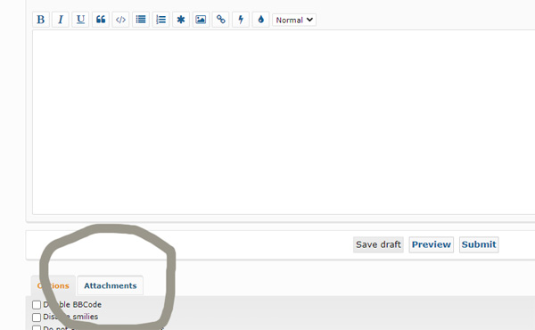

Use the attachments tab at the bottom of the new post box. After attaching an image. Be sure to click place inline.
