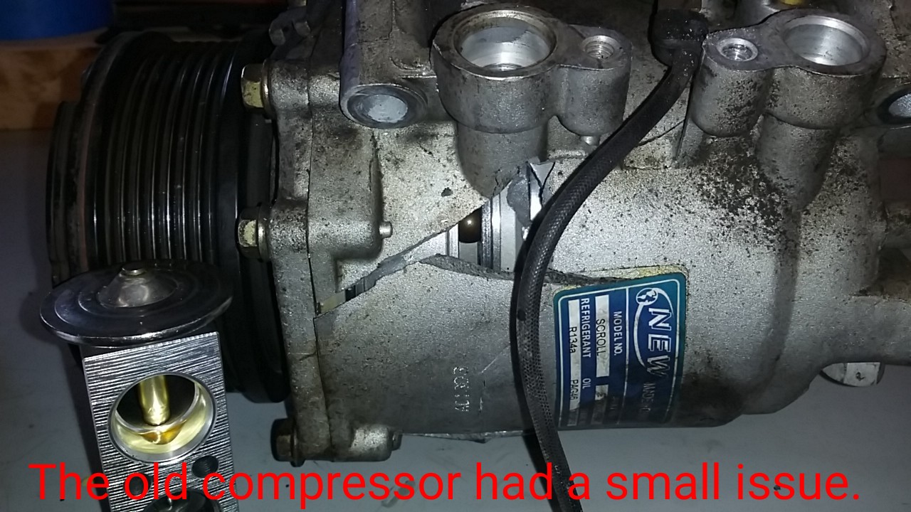

The last one was a new China scroll type and lasted 6.5 years then exploded (hope Pic is attached).

trigger_thyme wrote: Sun Jul 25, 2021 3:31 pm The last one was a new China scroll type and lasted 6.5 years then exploded (hope Pic is attached).
Very good longevity for a scroll, I'd say. I don't see a picture, though.

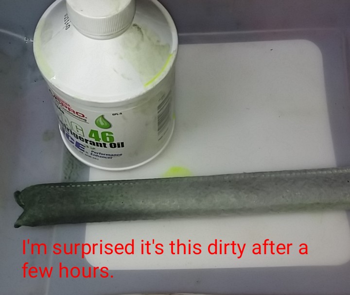

Sir, I'm not too happy with the way this new desiccant bag looked. I will try to attach a photo. It's under vacuum now. I was very thorough with my flush and it still looks dirty. Maybe I'm just thinking it should be perfect, but that's not what I expected. 🙁
I'm trying to attach a photo of the old compressor. It didn't leave black death throughout the system. Just kinda let go all of a sudden. My son and I will be dissecting it soon.
Just wondering what the dark is on the bag I just removed. Possibly the compressor was breaking in? I really hope this system lasts longer than 6.5 years.

trigger_thyme wrote: Mon Jul 26, 2021 5:36 pm I'm trying to attach a photo of the old compressor. It didn't leave black death throughout the system. Just kinda let go all of a sudden. My son and I will be dissecting it soon.
That's a pretty impressive compressor failure. Could be that something broke internally causing the case to rupture, excessive pressure, or even metal fatigue. Let us know what you find after you take it apart.
trigger_thyme wrote: Mon Jul 26, 2021 5:36 pm Just wondering what the dark is on the bag I just removed. Possibly the compressor was breaking in?
I don't see any identifiable particles, which is good. The staining looks like very fine aluminum dust that possibly remained in the evaporator after the first compressor disintegrated. Some small amount of residue might have been left in the new compressor during manufacturing or, as you mentioned, sloughed-off from breaking-in. It's hard to tell, but at least the desiccant bag absorbed it.
