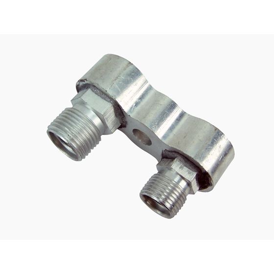

A messed-up muffler could be the reason I was seeing such weird readings on the high side (EDIT: Nope - see next post in the thread): No high pressure reading at all -- AND still seeing negative pressure on the high side when manifold pulled off compressor. I think I need to get rid of the muffler. What's the best way to do that without getting a new manifold connector?
Here's a stock photo of what this looks like

There has to be a way to have a new custom line made to eliminate that muffler.
Tim might have something like this available, just change the pad mount.

Keep the muffler. Just do something about the connector fitting. Why not pruchase your own manifold ? You will use it enough to make your money back.

As for the hose, cut the muffler out, weld barb, and replace a section of hose.
Places like Cold Hose can do it. Best to find someone locally. Then there is buying the tools to do it which are not cheap.
