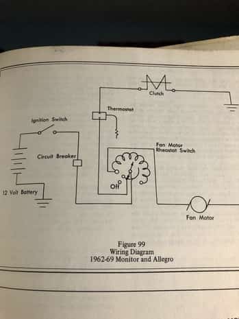

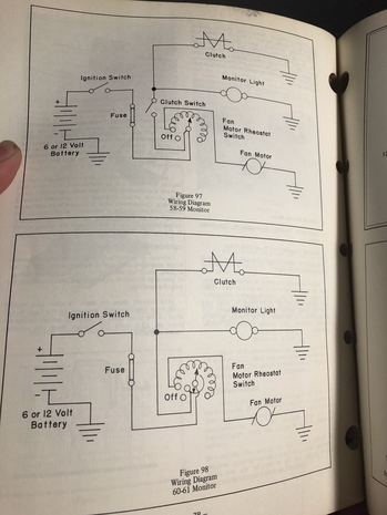

This old Mark IV has no thermostat. I recently bought a service manual for Mark IV ac. I found the wiring diagram. (See pictures) When I look at the temp control it looks like a huge device into the evaporator core without power connected.

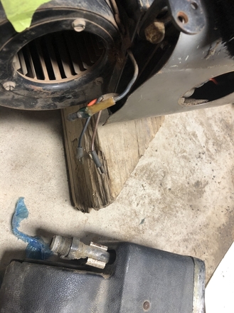

I have 2 of these & both have the fan wire connected. (See picture) The only wire loose is the brown wire that’s supposed to go into the clutch fan? How do I wire this thing up? I want to go with a sandon style.

I hooked the brown wire up as the fan. Still not sure what runs to to the compressor side.

I spoke with someone and my hypotheses was right. There is no bulb for temp sensor but it is actually built into the switch itself. I will take apart my parts mark IV soon to look it over.
